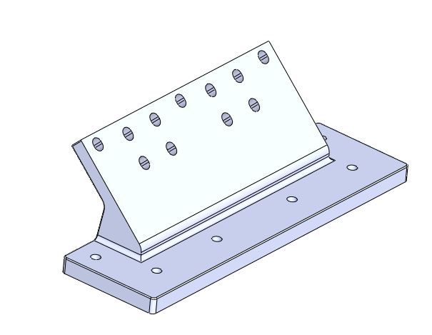

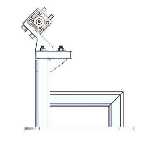

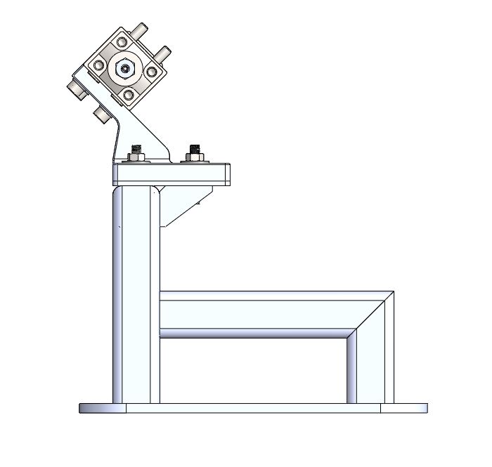

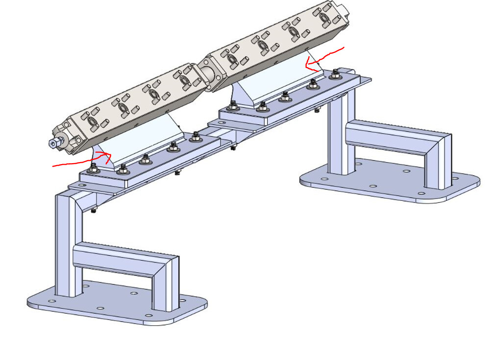

Hello all, I am designing a fixture to be 3d printed out of PA12 Nylon via MJF technology. I need to understand if the material is strong enough to hold the weight of the manifold (plus valves and fittings). I have no training with FEA so am clueless on how to go about simulating this. I have hidden the valves on the images as these are IP, but the manifold and valves will be bolted on to the 3d printed fixture which itself is bolted to a welded stainless frame.
