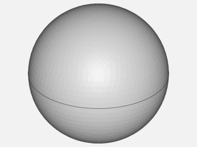

I have found one “Terminal Velocity” project, but it seem to be outdated, I have no idea what is needed to update it. Does any one have the time to have a look at it? If it works with the sphere I assume I can get it working with the model.

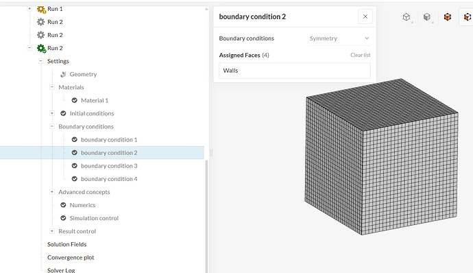

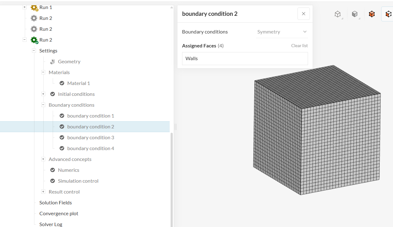

The (very old) project you shared seems to have only one successful simulation run in it. You can check out the settings applied to run that simulation within the tree of that simulation run under ‘Settings’ as follows:
However, the project does not provide much help to achieve your main requirement which is terminal velocity calculation. Since you are new to SimScale, let’s first break your problem / requirement down to what we want to extract and what’s the best way to do it would be.
