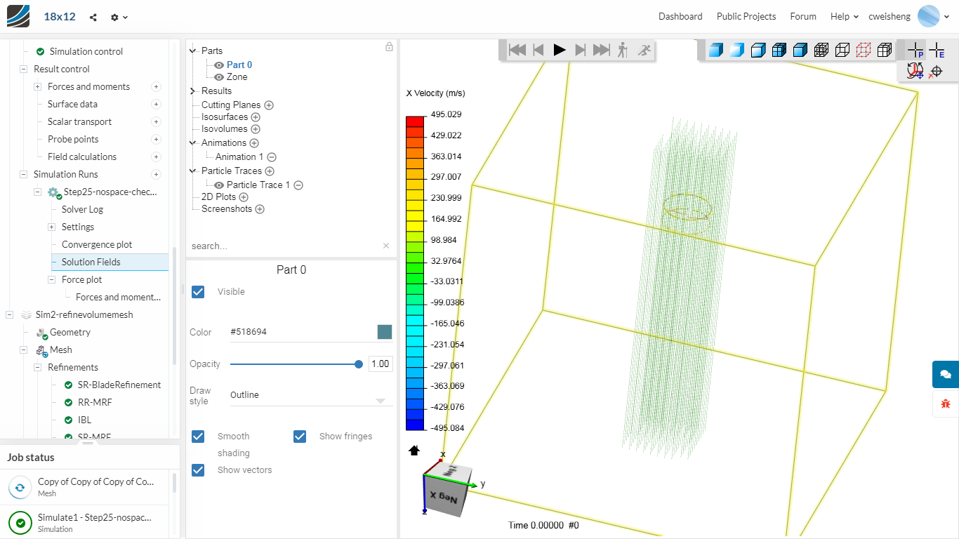

Thanks. I understand it does not physically spin but the flow velocity should be “spinning” and so I should see some swirl in the flow particles?

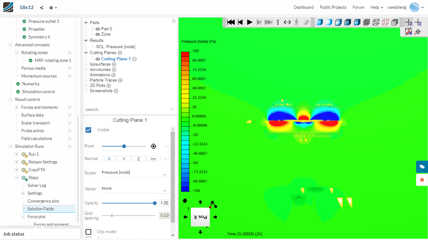

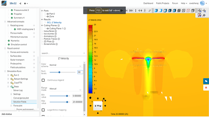

The planar cut through the propeller seems to suggest it is generating some thrust with the pressure field
And there is momentum imparted to the flow
In the images you can see some discontinuity between the MRF zone and the rest of the volume.

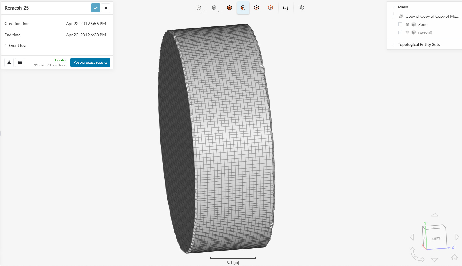

Also, if you have a look at the Zone mesh, you’ll see that the edges have not been properly captured. Add a feature refinement, in order to better capture the edges of the cylinder.

Based on the screenshots I have sent, are you able to opine if the MRF is working? I still think there should be flow rotation/swirl?
You use particles trace and you see by yourself that flow does n ot rotate. Did you checked your naming convention, please?

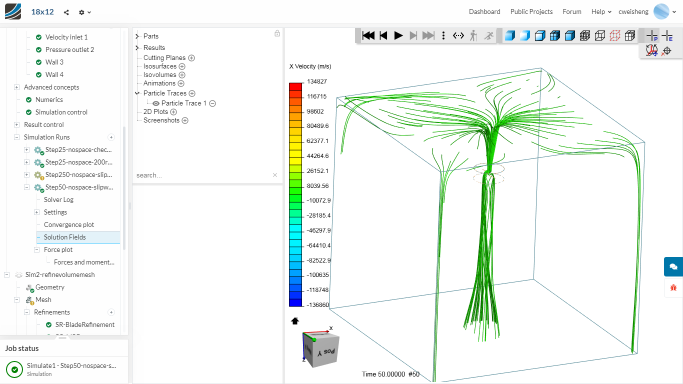

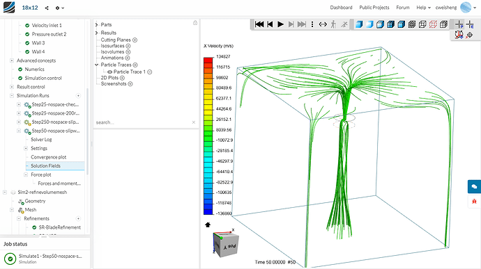

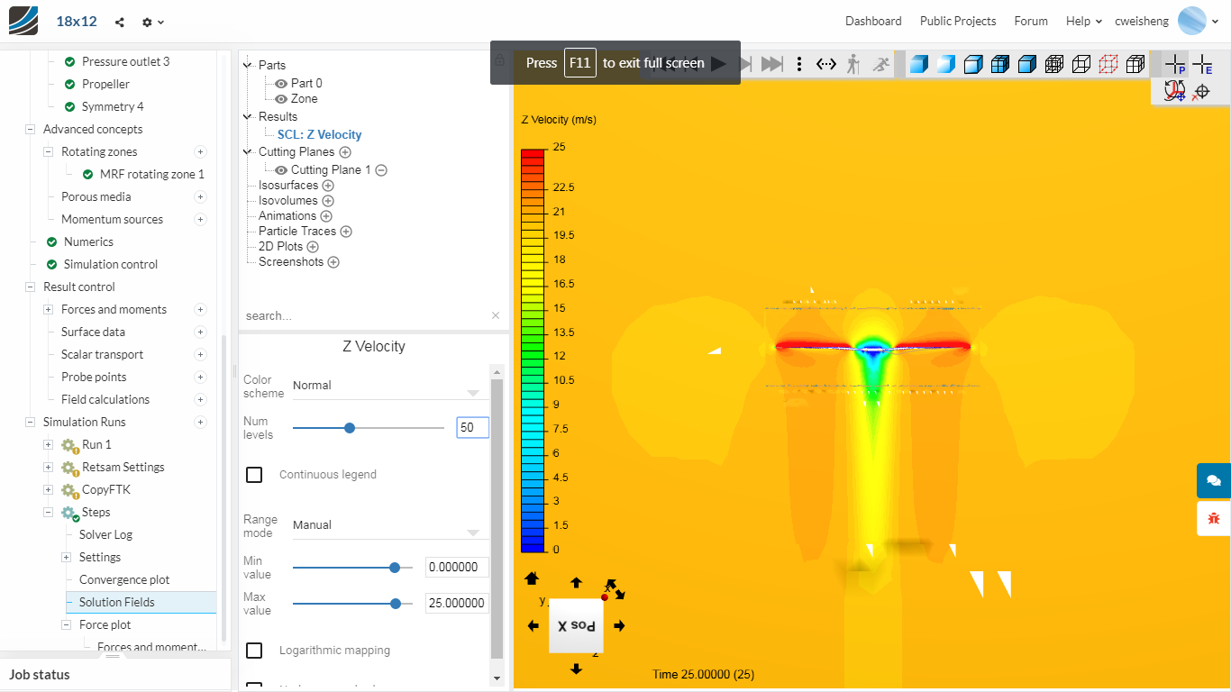

Took one of your suggestions… to run with 0m/s inlet… Must say I was not expecting this at all…
Hmmmm… what the… Anyone?
Where is the outlet? (have not looked at project recently but just that weird image :wink: )
Its at the bottom of the box as per above picture.
