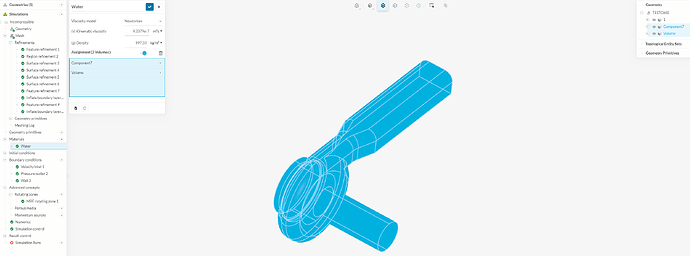

Hi there. I’m trying to simulate an MRF pump and created a mesh out of the geometry. When I try to assign a material to the volume the tree on the top right doesnt show my new mesh but shows the CAD geometry.
as shown in the image below. This will make the simulation take the geometry as a domain and not the mesh.
If I go ahead and assign bc’s on the geometry again because the mesh doesn’t show up in the tree, the simulation error pops up.
I’d appreciate any help and importantly how do I select the mesh as a domain. There’s no selection button in the mesh dialogue box to choose it as a domain. Thank you

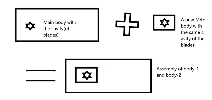

EDIT: Sorry, I couldn’t give an extensive explanatiopn on how I solved this issue as I was busy preparing for my exam. Here is the method I use when I work with MRF problems.
  1. Your CAD will play a very imp. role in the process of formation of a new cell zone. I usually make my CAD model in this format-
    In your CAD models your blades are solid so, my first step was to use boolean cut operation to make that cavity in both the MRF cylinder and the main body. Thus there was no need to make a new assembly from scratch. Then I made a new mesh with MRF zone by using the “with cell zone” option in the surface refinement .
I made some modifications in the CAD model and now the MRF zone has been created properly and it is now able to assign B.C’s to the mesh surface. I am attaching the project link here- https://www.simscale.com/workbench/?pid=8500429970281485035&mi=spec%3Ad0d56b41-419e-4911-b8f5-5ef054630107%2Cservice%3ASIMULATION%2Cstrategy%3A2
You can either download the CAD model and assign desired mesh refinement in a new personal project or you can simply copy my project and work within it. Hope that helps :slightly_smiling_face:

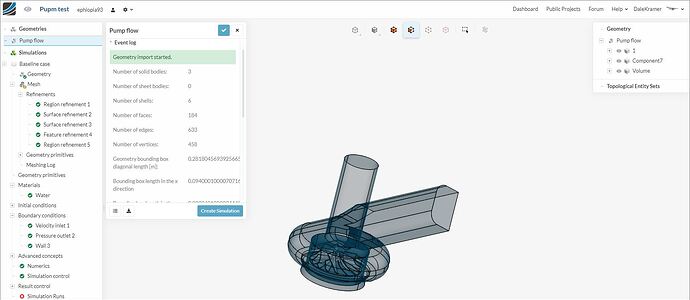

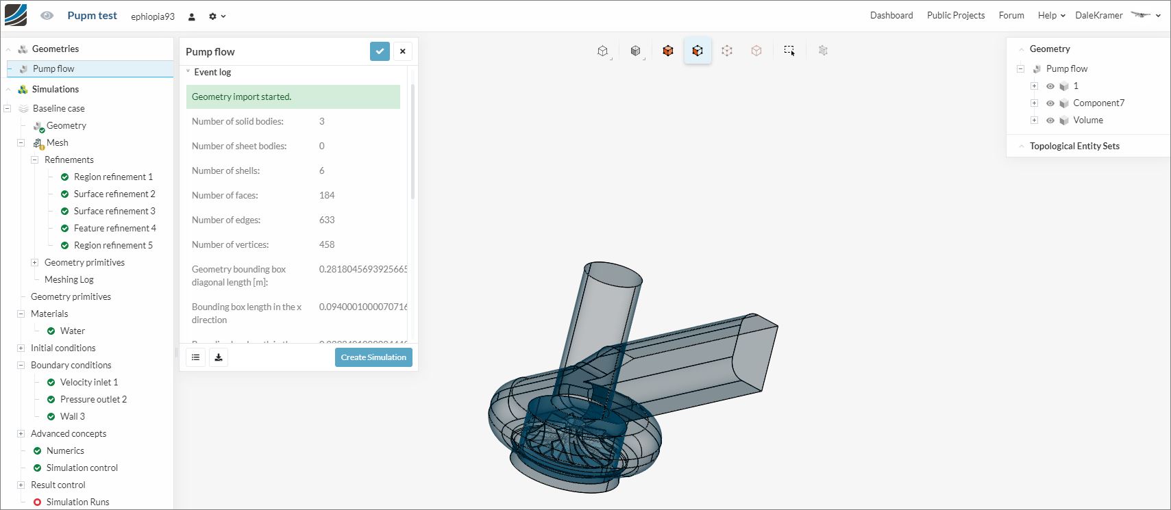

I opened your case in your post #7 and the first thing I see is that there are still 3 solids, in the only geometry, in that project.
In Retsam’s Post #8, he shows you a project that he created to help people currently having a problem with internal MRF simulations. Currently you must follow his recommendations and if you did, you would have only 2 solids in your geometry.
Please modify you geometry accordingly and try everything he suggests in his sample project…

During the assembly of body 1 and body 2, wouldn’t the surfaces of of blade cavity in body 1 overlap with the surfaces of blade cavity in body 2? So, though the surfaces will be joined to each other , they still act as two different surfaces. How to provide boundary conditions for both the surfaces, to make them act as one?

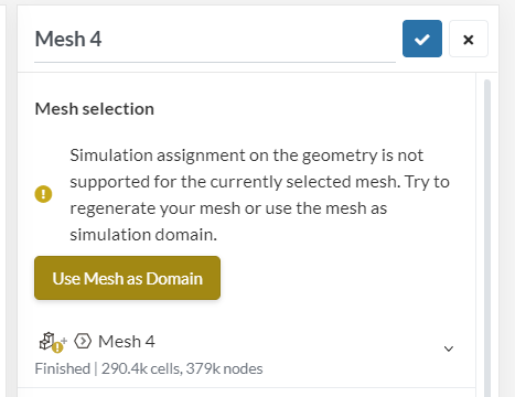

I am still getting similar errors:
  1. Mesh cannot be selected for boundary conditions
  2. Prop inside the refinement boxes not being meshed - I tried both making it a solid and negative geometry inside the fluid domain.
  3. After meshing (and spending core hours) I get this message
Here is the link to the project: https://www.simscale.com/workbench/?pid=3724086337920935062&mi=spec%3A49cdd096-10f0-4d5b-b222-ce2f8d931fd7%2Cservice%3ASIMULATION%2Cstrategy%3A24&ps=analysis%2FIncompressible--oneOf%2FboundaryConditions%2F0
Hope you guys have some insight
Hi @joshuaxdmb!
You can just click on the button to use the mesh as the domain, that’s fine. Also regarding your setup before you jump back to it.
