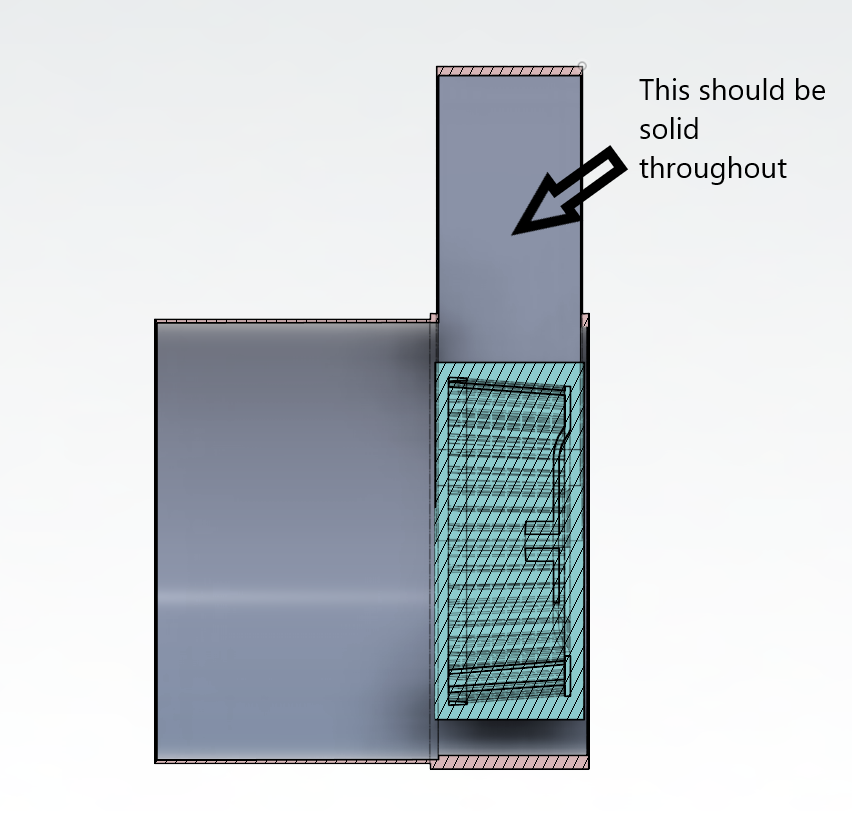

Hi @redwanpranto15
You need to first work upon your geometry before trying to make a mesh. The domain through which your fluid will flow is not right. I am attaching an image for your reference. Also, you can take a lok at this post in which I have described how to make a geometry to make a successful MRF region- Issue with assigning mesh as the domain
