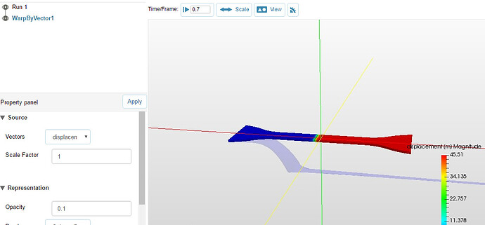

Hi @yw5aj,
Attached is your displacement compared to actual geometry
It is pretty simple, just go to "warp by vector"and then click on desired “Field (von-misses stresses/deformation)” and also add “opacity” as seen in the picture.
As anna pointed out, an Youngs modulus of 754 N/m^2 is very low compared to other materials like Al, Fe etc.
Hope my suggestion on warp by vector was helpful.
Cheers !
