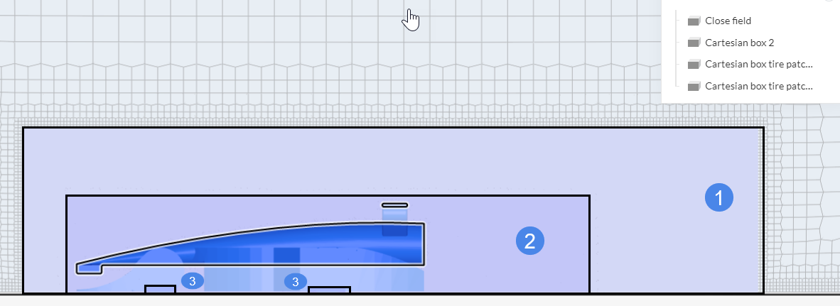

Hello rdunnings,
I was able to create a mesh setup that seems to get the drag coefficient in the right direction.
1 It seems like the mesh has to be way finer. ( I’m currently running simulations around 5Mio. Cells.)
Mesh Settings
Hey dominant meshing level fine
Mesh Refinements:
  1. Wake refinement Maximum length 0.002m
  2. Near field refinement Maximum length 0.001m
  3. Tire patch refinement Maximum length 0.0005
In addition to this, i have created Surface Refinements for the car.
Small edges of wings and Bodywork: Min length 1.25e-4 m Max length 2.5e-4m
Tire Surfaces and gab between Tire Cover and Tire: Min length 1.25e-4 m Max length 2.5e-4m
Big Bodywork parts: Min length 2.5e-4 m Max length 5e-4m
The result i got was 0.22 for the drag coefficient. I guess that a bit more refinement need to be done but I guess that this is a good starting point.
