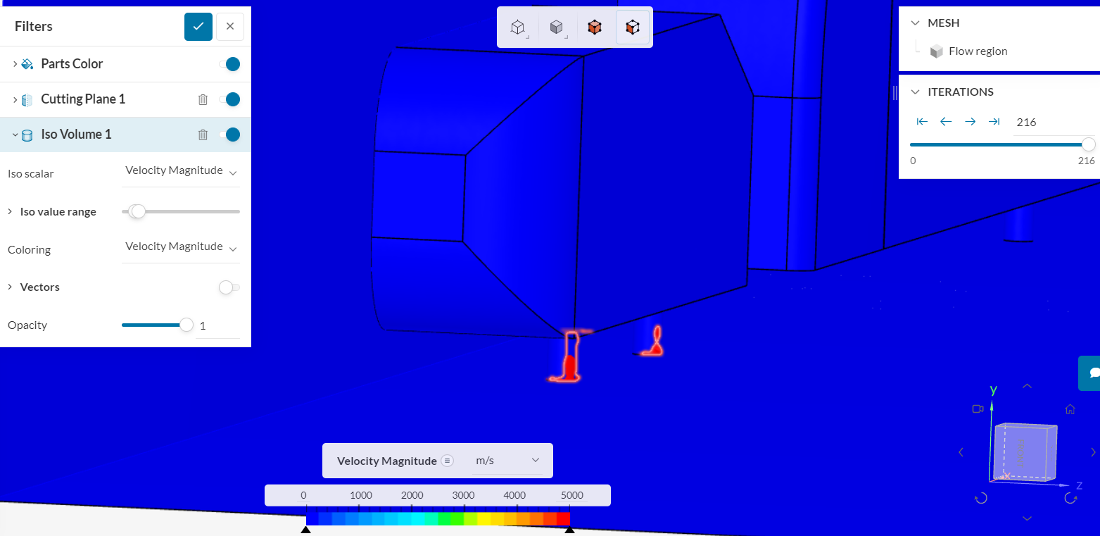

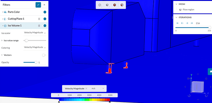

I am running a simulation with two vehicles in a platoon sequence at a flow speed of 60 m/s. When I check the post process results, the forces and moments coefficients plots go crazy for the leading vehicle and I also find out that there is a region in the geometry model that reaches 5000 m/s…
I have already tried simulating those exact same vehicles but with a slightly larger separation distance between them and the results seemed fine, I just do not understand why for this case the flow goes crazy at the bottom of the leading vehicle.

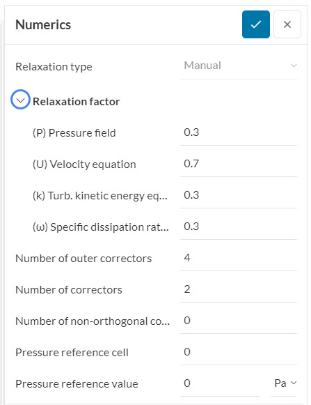

You can also try to reduce the relaxation factor for velocity, this should also result in a more stable simulation.
