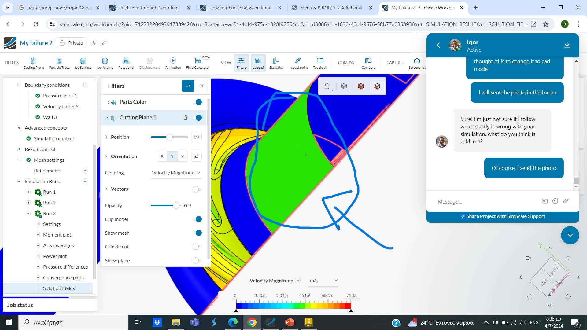

I have to force mesh extension to import it into simscale. That is I have a rotating area inside but outside I have a fixed wall. But with the extension of my grid, it automatically passes it as rotaning zone and I want it to be stable
From CFturbo programm
I need some help. Do you know anyone who has done imports from the CFturbo program to Simscale so I can work around this issue?
The issue is in the switch where in the solution if you see the wall rotates while I want it to be stable.

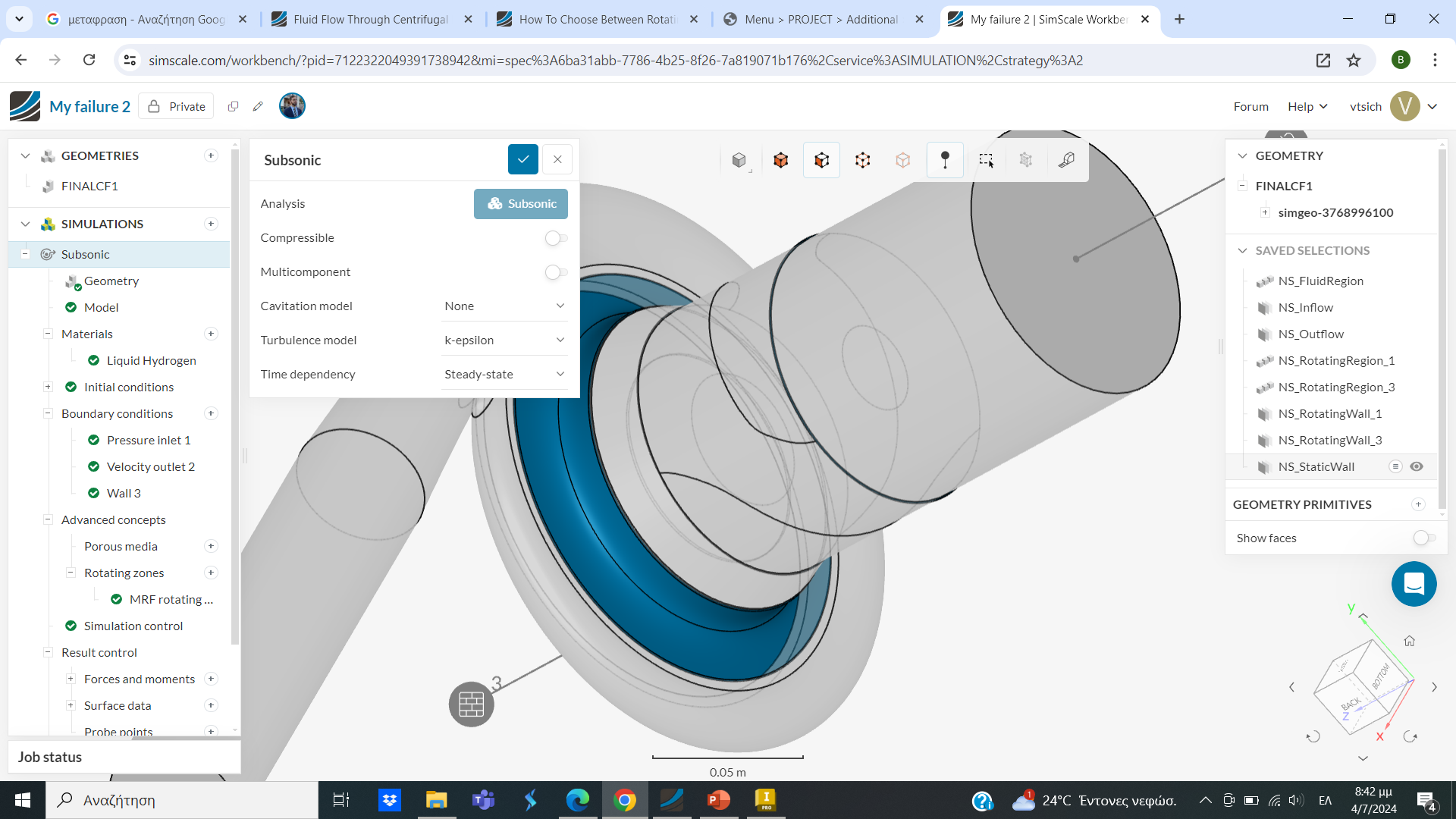

If I set the inner wall to no slip wall and the outer one to rotating zone because I can’t change it will it show an error?
The rotating zone will be applied to a volume, so you shouldn’t be able to apply it to a single wall. Make sure to know the difference between rotating walls/zones by checking out this resource:

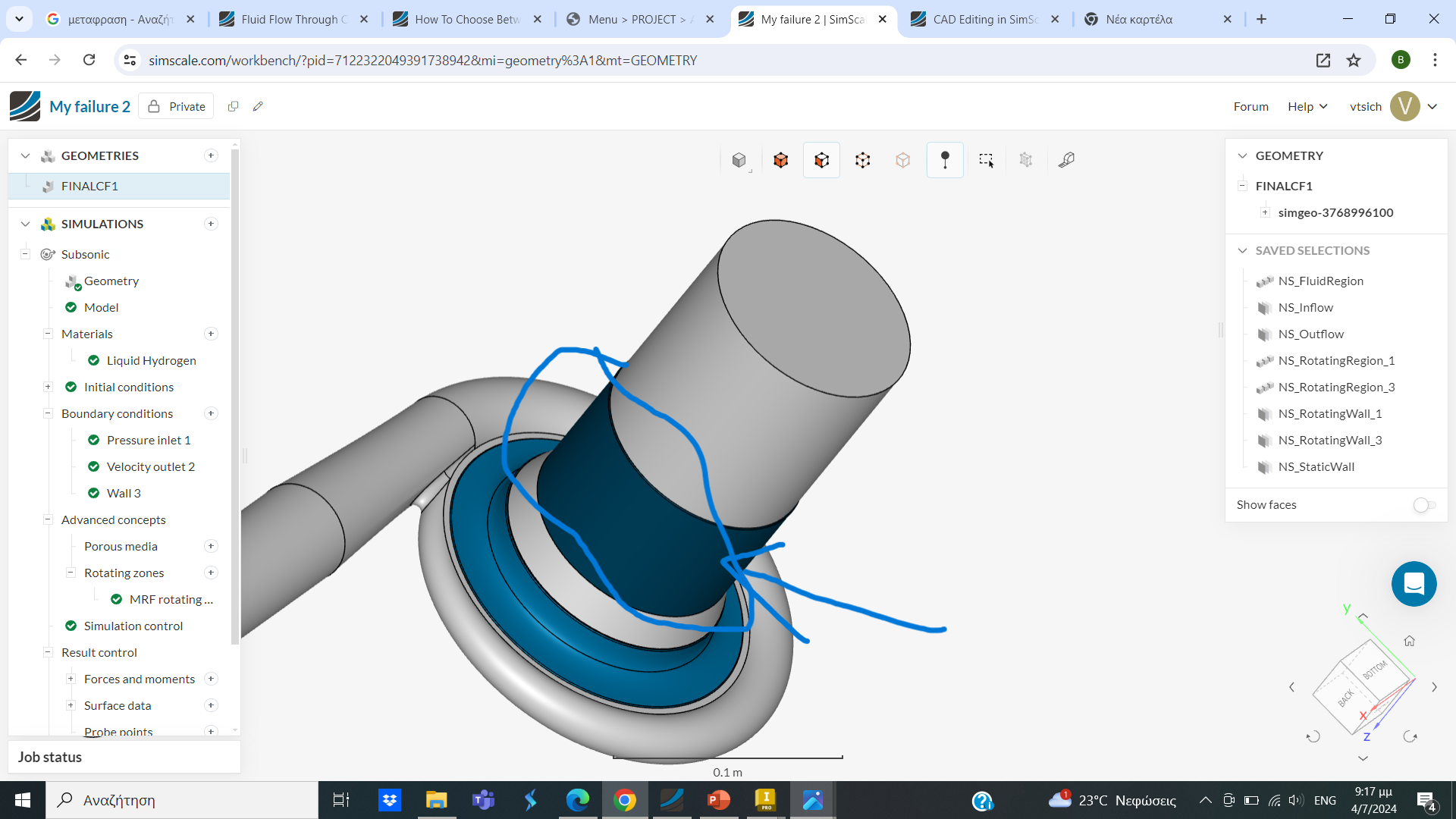

Although the velocities don’t change that much compared to above where I have fixed walls.

To prevent the walls which interfere with the rotating zone from rotating in the Subsonic solver, you’d just need to set them as no-slip walls. If you were to use the Incompressible solver, however, you’d need to set them as rotating walls with a rotational velocity of 0 (as it’s done in this tutorial).
Tell me if that helps.
