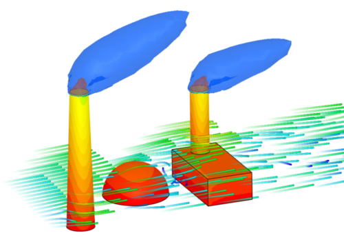

The first uses passive scalar to calculate the concentration of smoke:

However, the passive scalar will not affect your simulation / fluid behavior.
