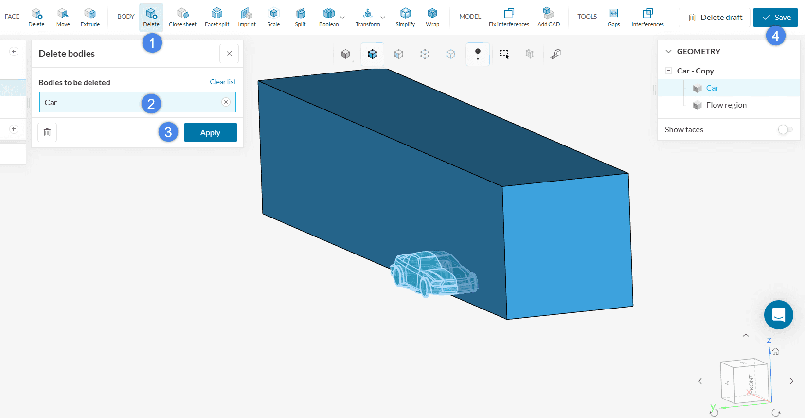

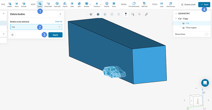

You are probably trying to simulate a fluid with the flow region overlapped with solid grometry, try and using the edit geometry option to delete the solid geometry from the flow region!
Any “Easy” rated external flow tutorial here on the site will show you how to delete geometry from flow region.
Please refer to this tutorial for the usual workflows, in particular when it comes to the first section, related to CAD preparation.

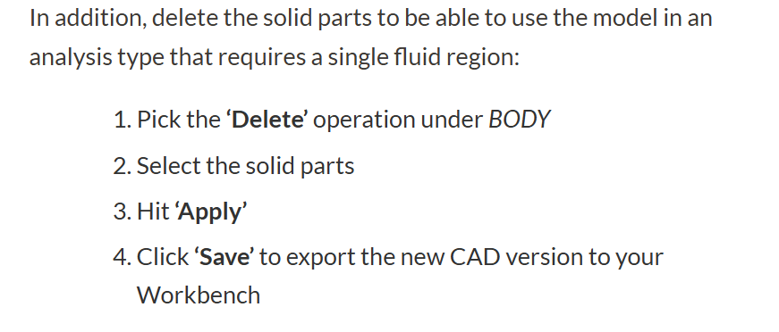

Perhaps, creating a fluid volume for your geometry is necessary. This documentation page/tutorial shows the steps to do so: How to Create Flow Volume Extraction? | Knowledge Base | SimScale
Note from the above tutorial,
Or, you can also see how to delete a body from this general documentation page: CAD Edit | CAD Preparation & Upload | SimScale
