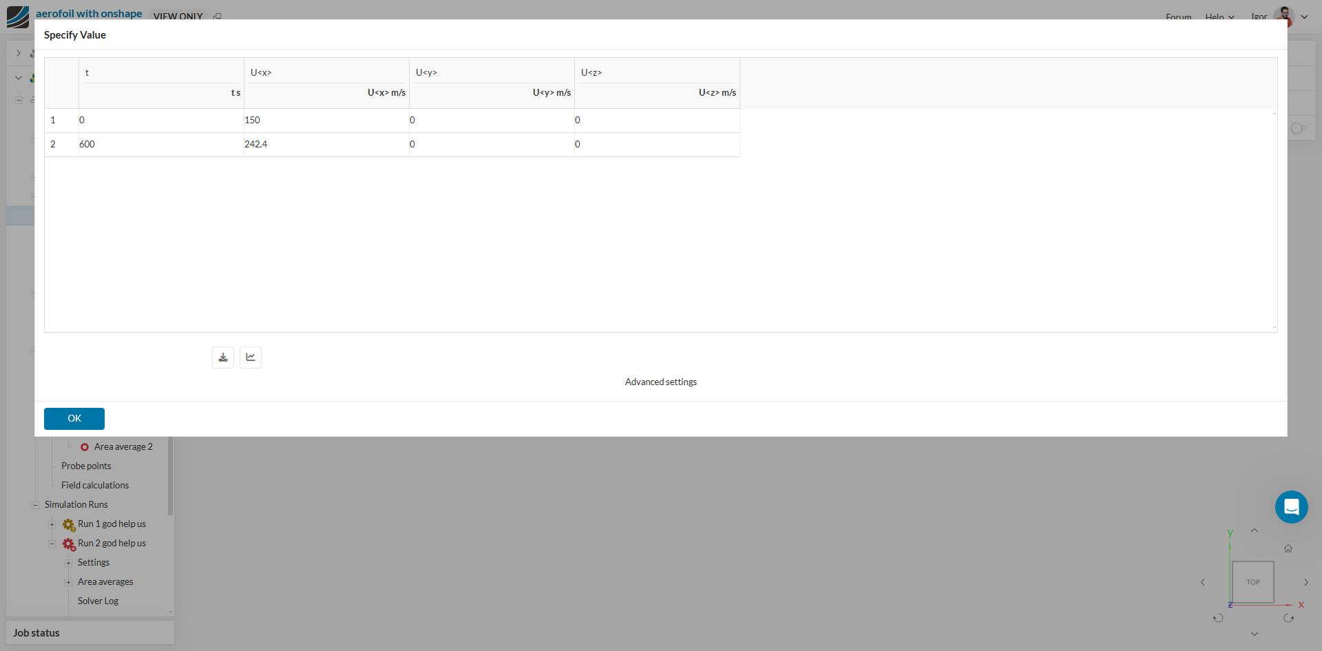

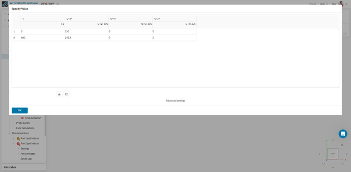

I tried to solve this error by mending the boundary conditions ramping the velocity and cross-checking with the tutorial, but it still didn’t work.

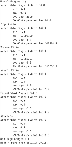

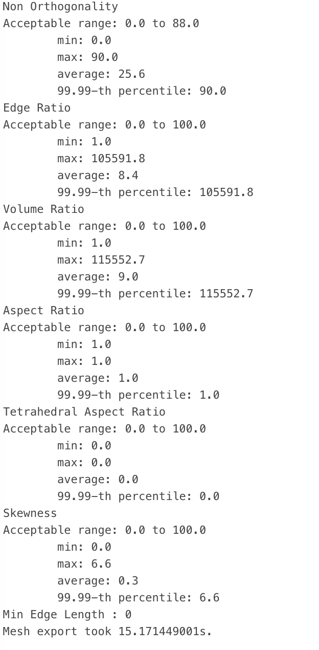

I checked the meshing log and quality and turns out my Non-Orthogonality, Edge Ratio and volume ratio are way out of bounds but I have no idea how to fix it. The documentation, Mesh Quality | Mesh Visualization Tips | SimScale, on these meshing quality terms, doesn’t show how to actually fix it.

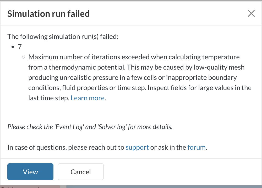

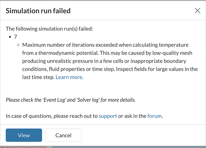

Newest error message
Old error message
Old meshing Log

Regardging the velocity ramping, try using the same sort of ramping (just changing the direction) used in the tutorial. Starting with 150 m/s is still a big punch for the solver to handle.
