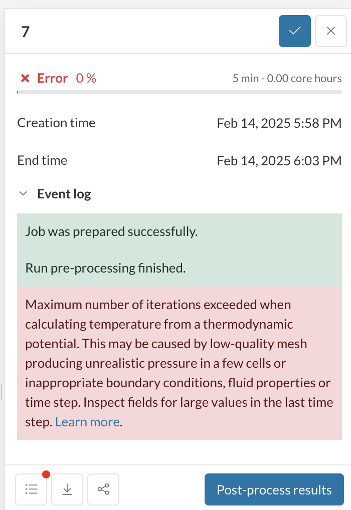

We are having issues with the meshing on a project of ours and all the tutorials we have received from the SimScale website and other sources have failed to solve or address the issues. The main article we used is this one https://www.simscale.com/docs/tutorials/tutorial-compressible-flow-simulation-around-a-wing/. The mesh settings this one uses are outdated. Simscle has massively updated the meshing process and completely changed how to see the meshing quality from what was described in the detailed video. The mesh refinements as described in the video aren’t available in this new updated version and we used a different article, Aerodynamic Flow Behavior Around a Vehicle Tutorial | SimScale, and used the settings from here but still showed the same error messages, attached some that were shown. Here is the project I am working on SimScale Login. This is the link to the meshing component which we are have issues for here
This is the error messgae
The tutorial that you mentioned was updated around a week ago with the new mesh nomenclature. Have you already gone through it?
Hi @gupta126579,
In addition to @RicardoParis’s comment (make sure to check out the updated tutorial), you could create volume custom sizing refinements to better capture the surroundings of the airfoil. I think ramping up the velocity from a smaller value might be worth a try!
