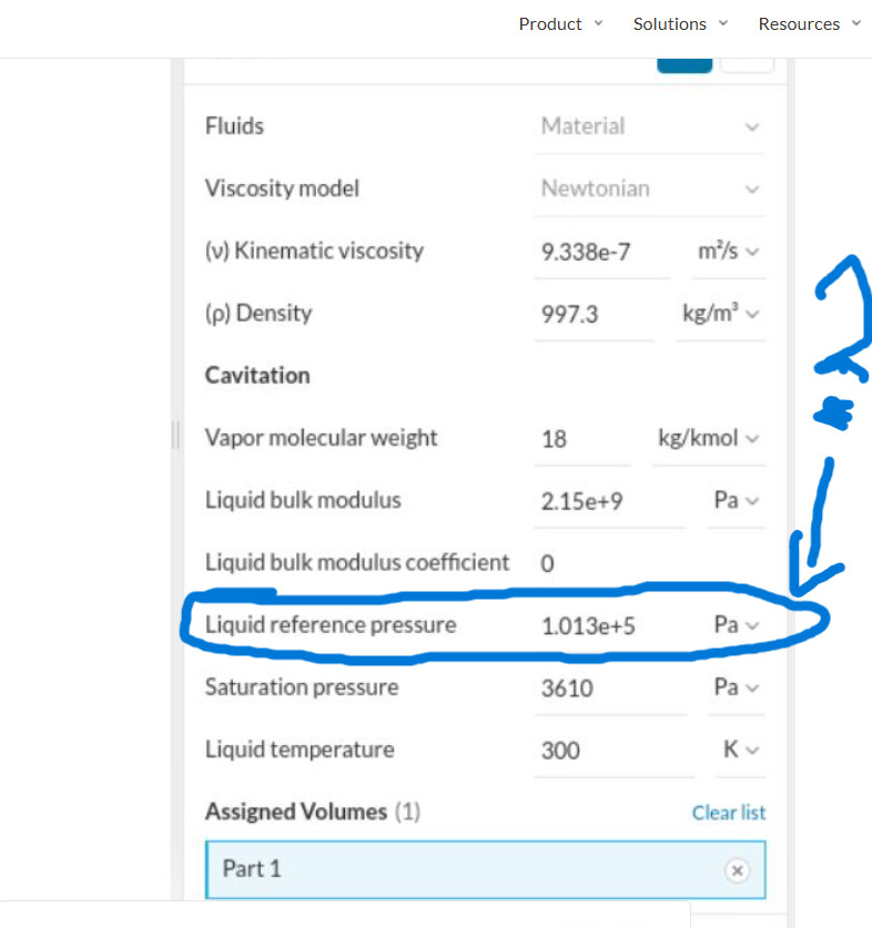

Hi ! I read on the Simscale website that the reference pressure in the cavitation model is used to calculate the density. Is this pressure the same as the inlet pressure in the pump or does it have a different meaning? I am asking this question because I used the cavitation model in cryogenic fluids and I believe I made a mistake in this value as I did not change it.

Τhank very much. I don’t have some project to run. I just want to understand the pressure on the image that I circled
I just want to know theoretically if it’s possible.
Hi @t_vaggos007, from my understanding this is simply the baseline pressure from which you retrieve the fluid’s properties
Thank you !
