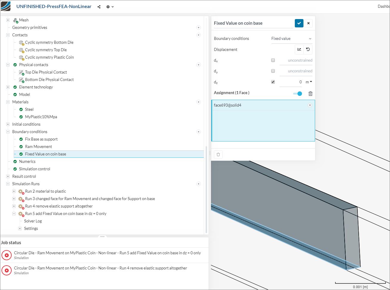

EDIT: Run 5 still no joy :sob: , unconstrained error by doing this:

Your 1 Degree sector is causing really badly shaped elements in the Coin near the center. Maybe if you did 5 degrees the aspect ratio will not be so bad.
You Fixed the bottom of the coin in Z so this totally eliminates the bottom contact . I would remove this and go back to the elastic support.
I don’t think the top of the press is constrained on the initial calculation so I would try a Elastic Support on the top surface in the Z direction.

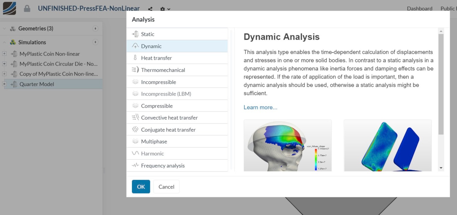

Where do I find a Dynamic solver or is it one of these :question: :
See my comments below.
@DaleKramer
Dynamic is the solution Type.
Ah, a dynamic analysis, not a dynamic solver … UGH another Analysis type to learn :wink:

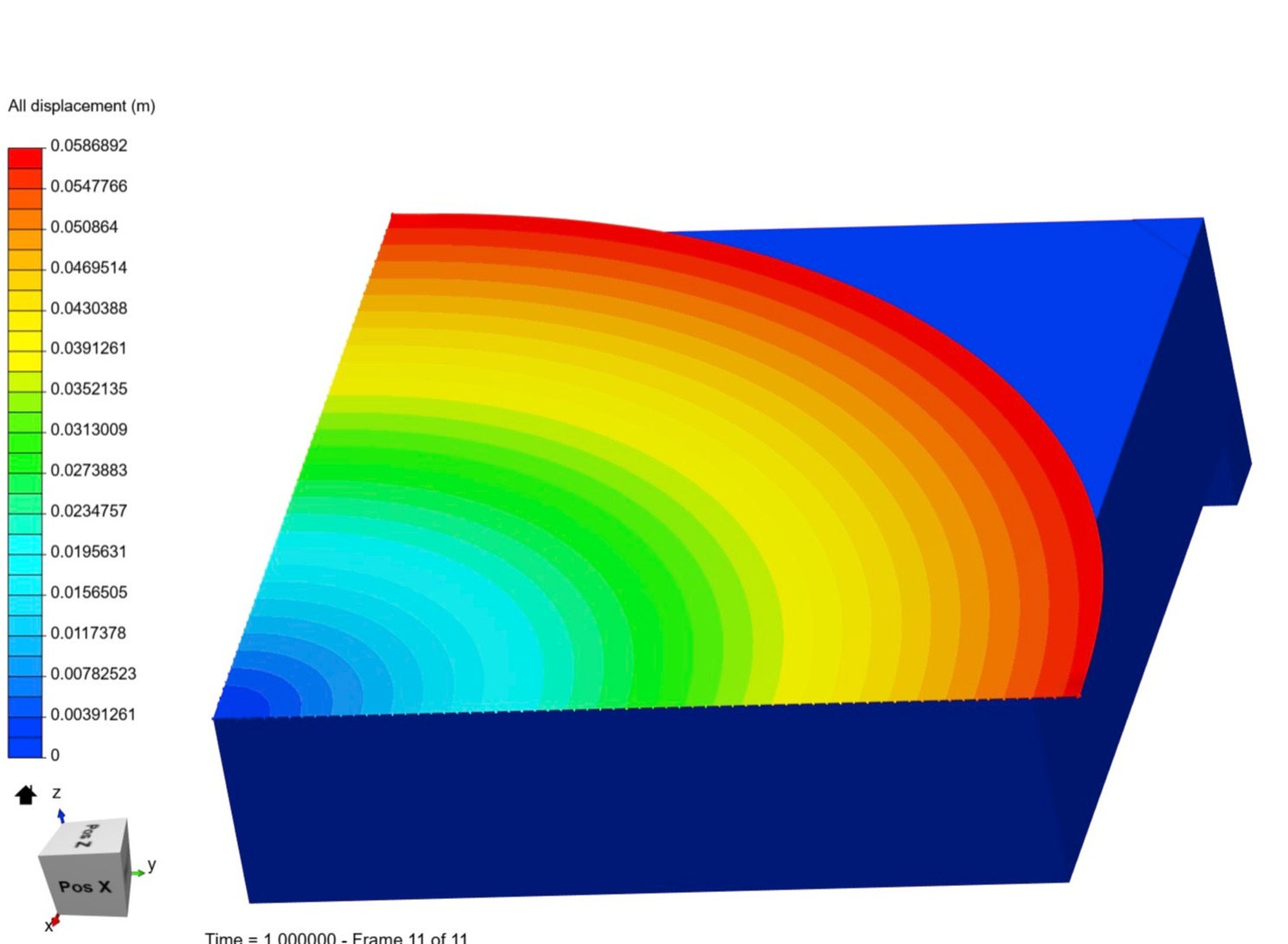

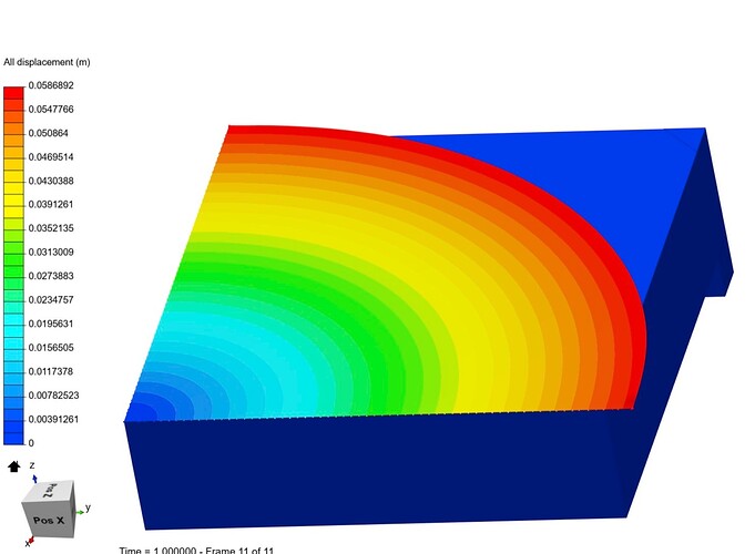

I went back to a quarter model and aligned the side to the global coordinate system and I came up wit the following results.
You can see the Quarter Model Here.
It ran in about 6 minutes.

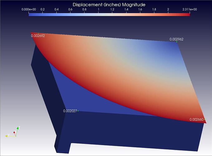

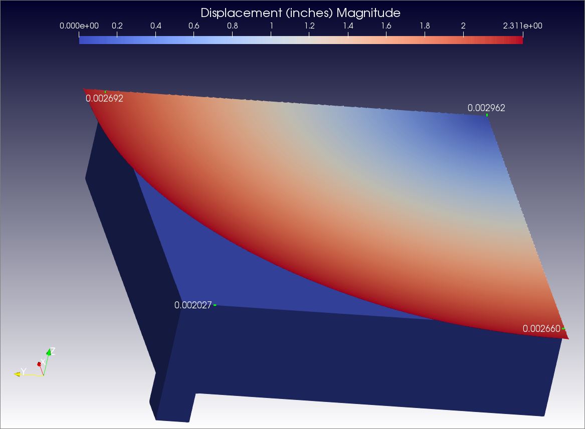

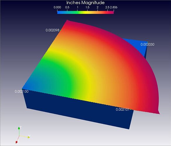

I the meantime I used your Quarter model and made the plastic ~10 times ‘softer’ so the coin diameter would increase due to less ram force which causes less flexing in the die plates.
Ideally I want a uniform 0.002" think plastic coin.
Here are the dimensions of your run in inches at various points:
And with my run with 10x ‘softer’ plastic (this got an extra 1/2" radius on the coin and very close to 0.002" thick almost everwhere :slight_smile: ).
