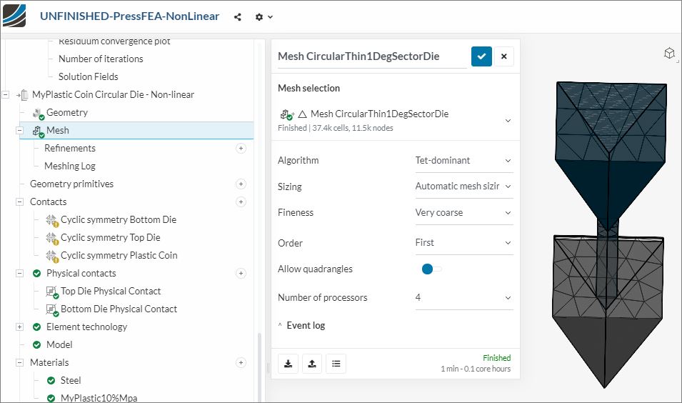

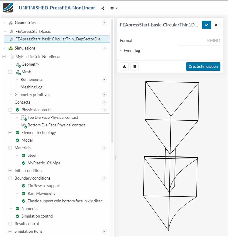

The geometry shows a curved face (not curved in Rhino):
BUT the mesh from that geometry is straight again:

What you mean, first image is of geometry and 2nd is a mesh made from that geometry.

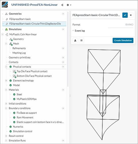

Here is a bent mesh too:
And the geometry shows as bent in SimScale UX , but different faces are bent:
BUT, in RHINO the bent faces are ALL planar faces:
Now we really need some experts involved quickly in case the mesh was really generated like that :sob:

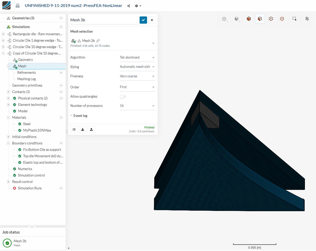

EDIT: We are closer but still no cigar…
I copied the simulation of Post 4, then I simply changed the number of processors for the bad mesh to 16, named it ‘Mesh 3b’ and regenerated the mesh. As you can see we have a slightly better mesh now but still one curved mesh surface that should be planar :frowning:

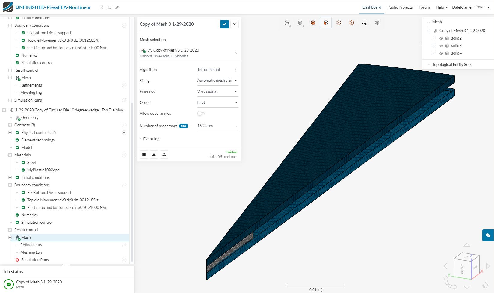

Today I did a re-mesh of Mesh 3 of post 4 here and the re-mesh is NOT BENT :slight_smile:
This problem seems fixed! GREAT!
