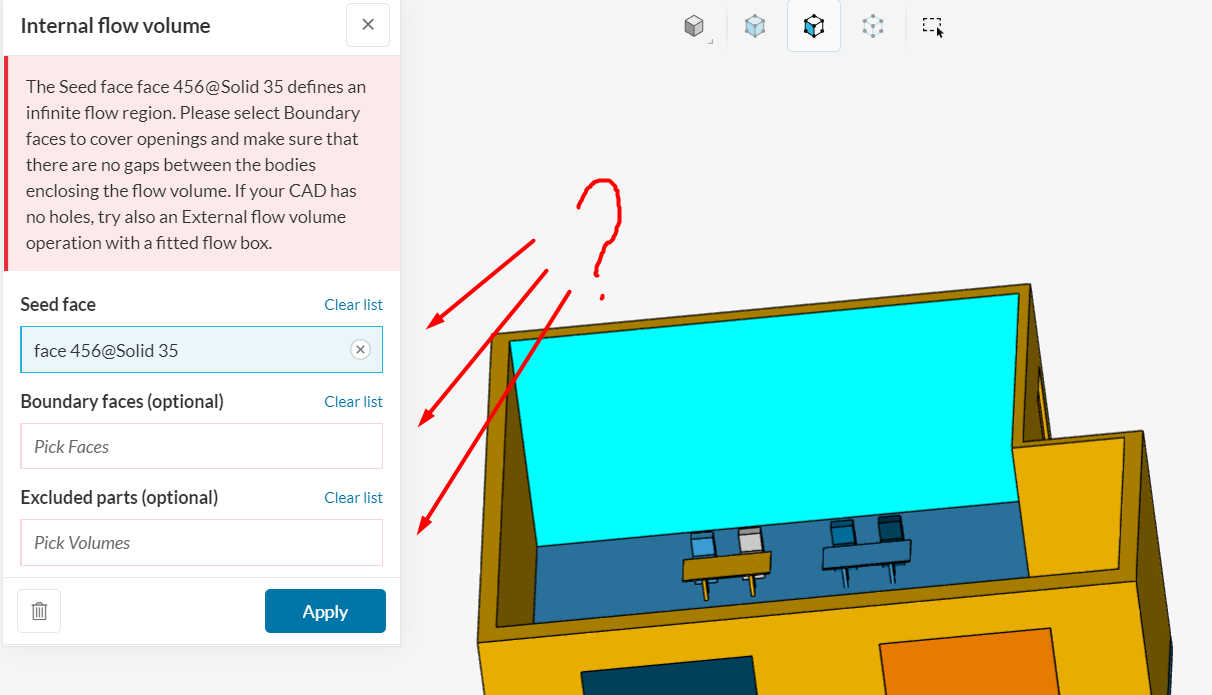

Whai should i select for seed face, boundary face and excluded parts?
Hi, the error message suggests that there is a gap somewhere in the model, connecting the environments internal & external to the room.
This could be for example a gap between the walls and the door/windows/floor/ceiling. I’d suggest double checking the CAD model.
On your question about boundary faces/excluded parts: please double check the article that I linked in my previous message. On seed faces, this article should provide more insights if needed.
