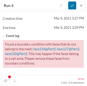

I happen to be having some problems assigning boundary conditions to the walls of the rotating pillar. I am getting the following error: " * Found a boundary condition with faces that do not belong to the mesh: [face134@Part2]), [face120@Part2]), [face127@Part2]. This may happen if the faces belong to a cell zone. Please remove these faces from boundary conditions." I cannot remove these conditions as they are the no-slip condition. Any tips?

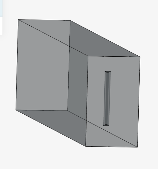

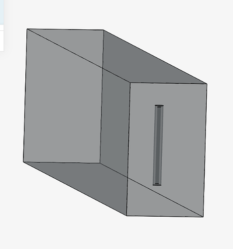

My geometry at the moment is:
I the cylinder inside is an mrf, housing the pillar I am testing.
I want to assign boundary conditions to this pillar.
when I try to do so the following error appears
Those face names refer to the faces of the pillar. Hope this clarifies the question.
Is there a way to overcome these boundary assignment issues?
Note that the pillar inside is not a solid, but a void. As recommended by the Simscale documentation.
Hey, this is because you set the Part 2 as a MRF region, so you should not apply boundary conditions on its’ faces. Have a look here for example:
