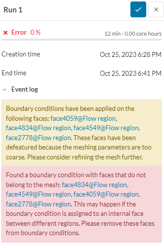

I am getting the error seen in the image in my aerodynamics of a miniature car simulation. Can someone tell me what is causing them/how to fix them? Im really not quite sure…

Thank you! I did what you said and the mesh generated well, though I am now getting this error :thinking:

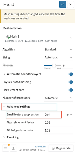

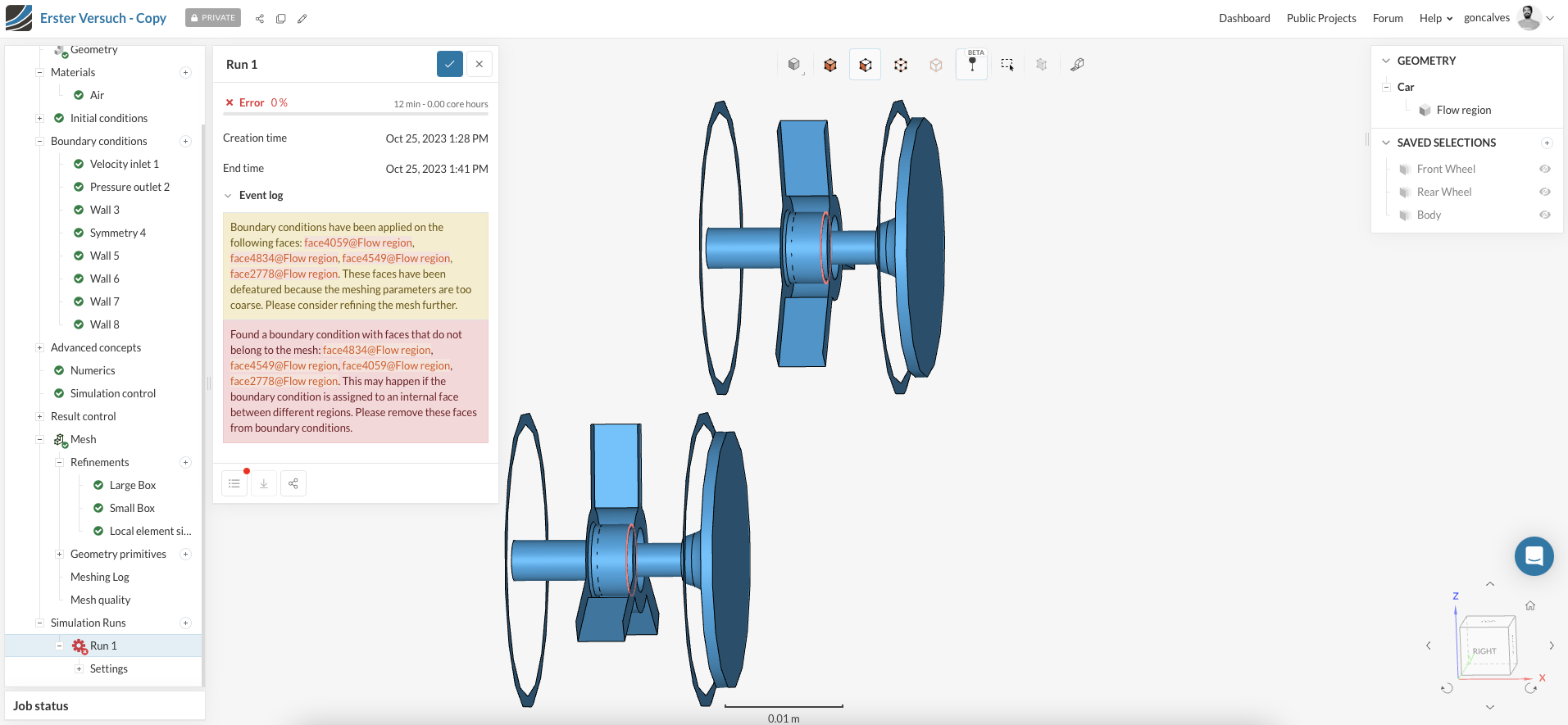

Thanks for the help! I fixed the error by eliminating the space between the wheels and the road. I then decreased the small feature suppression which didnt work either, as the simulation ran out of memory. After decreasing it again to 0.0001, I am now getting this error (picture) and have no idea what to do. I cant work on the model, as thats made by another person. Any help would be appreciated

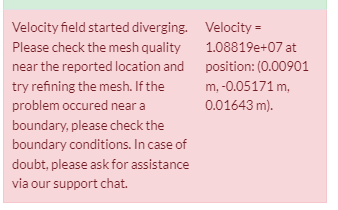

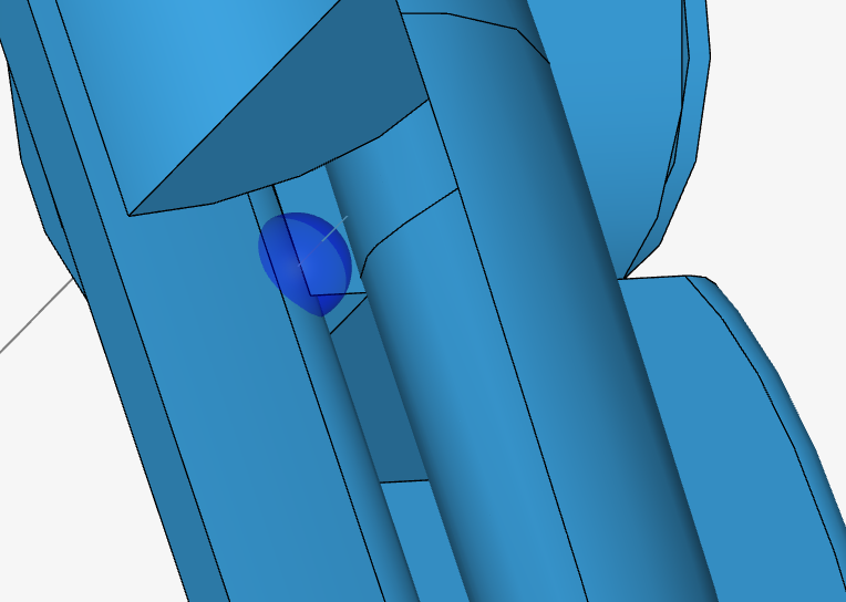

I now removed the faces from the boundary conditions, but now my velocity field is diverging again and Im really not sure why. Its just at a random point in the middle of the car
