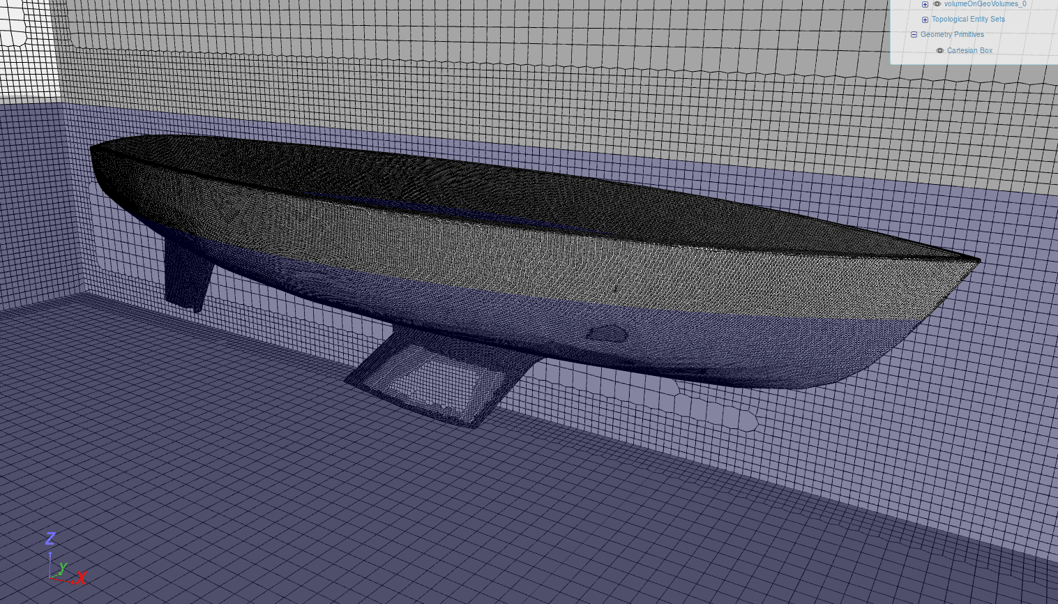

in a small side project I am looking into simulating the free surface flow around a boat hull to predict the waterline, drag etc.! First steps are done (see mesh below).
I did quite some multiphase simulation projects, but not many projects specifically for such a boat hull flow - so it would be great to have somebody else also have a look at this. Now it’s about setting up the simulation and validating the results. Somebody in the forum who wants to collaborate on this? Does maybe somebody even have a background in boat hull design/simulation?

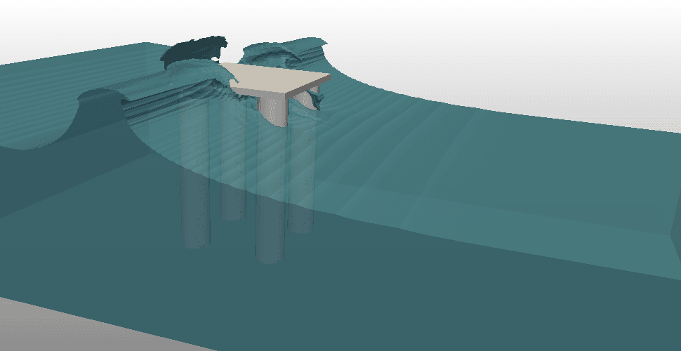

The impact of waves would be an interesting next step. However as the platform currently is not yet capable of simulating a floating object in a “6DOF style” I might wait for this until it can do this. But for steady objects, that already works, see here:
It’s this project in the library:

I can’t understand why there are so big elements under the boat?
@Igarizza, I’ll share it with you once there are some first results - unfortunately I did not have time over the last days to work on it. Regarding the mesh fineness: I refined the region of the free surface with a region refinement and the cells around the boat hull itself with a surface refinement. The image does not show a clipped view but a full view so the cells you are seeing are at the side wall of the computational domain. I don’t expect too much to happen over there so will start with this mesh. But let’s see how it turns out :smile:

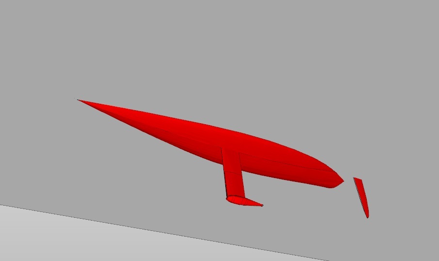

Hi dheiny, I have strong interest in this case and want to collaborate (if possible). A few suggestions on your simulation: your hull is too much immersed under water surface. As a roughly guide, water plane should pass through the inflexion point at the bow. Another important feature to include is heeling angle. Most of the time a sailing yacht will sail at a heeling angle, particularly when she goes against the wind. Normal angles can vary from 5 to 15 degrees.
I can provide you many geometries in .step or .iges format for you to include in a simulation tutorial of sailing/motor yacht hulls at different displacements and heeling angles.

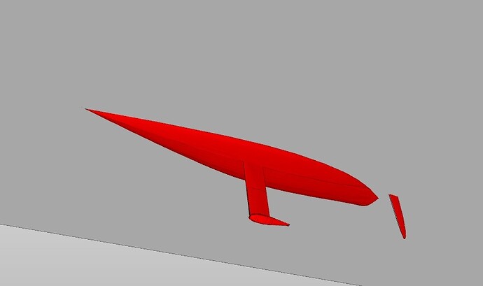

Hi David, I shared a project having a sailboat hull with appendages. Please let me know if you find issues, I’ll try to fix them…
I see now that my limit of storage for my free academic licence in Simscale is just 2MB, perhaps that’s the reason for the low quality of my .step file? It looks pretty poor on Simscale, while in other softwares it looks better.

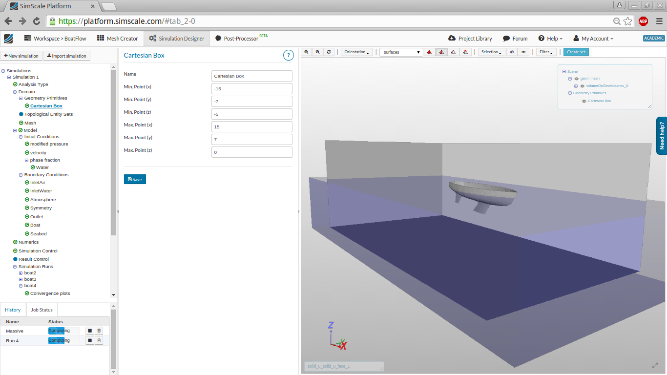

Any tips on how to define the 2 phases?
@dheiny, seems like something happened with my account when I subscribed to the forum, now it is a basic account and no longer an academic one… can it be fixed?
It will be great if Simscale accept .iges files, they are easier to handle.
I have many doubts on the geometry:
Must the water plane go into the hull? My waterplane is cut by the hull skin, it has a hole where the hull lies. I don’t know whether is it right. I’ve seen many simulations where waterplane goes into the hull.
Must the hull be splitted by the waterplane? Mine isn’t.
Sure! Once you create a new simulation, the initialization of the phases can be done using Geometry Primitives ([details here][1]). Geometry Primitives can be specified under Simulation Designer → Simulation → Domains → Geometry Primitives
How it works is, in the Phase Fraction part of the Initial Conditions tab, we switch to Subdomain-based option. Then, we specify the Default Value of the phase fraction. This initializes the entire domain to that value of the phase fraction (say 0).
We can then use a previously defined Geometry Primitive (lets say we use a Cartesian Box), to initialize only that part of the domain which is occupied by the box to the other phase fraction value (in this case, 1).
You are right, it is not exactly how one would want their boat to sail as :wink:, and we are looking at introducing more specific ways of initializing the domain in the future.
But I think it does not affect our simulation to a big extent. This is because we are not including Fluid-Structure Interaction, and hence presence of water in the boat does not affect the buoyant forces on the boat. It does change the movement of air inside the hull cavity - which can be safely ignored if the focus is on drag and wake studies on the outer surface of the boat.
One workaround could be to fill the inner part of the boat with solid material, so that it is not counted as a part of the domain.

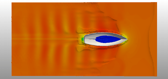

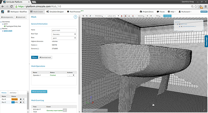

We have some results: the geometry for now is the original one that @dheiny used. It was initially refined to a high level of detail, but the element size there was too small for the simulation to finish stably in reasonable amount of time. So the mesh was coarsened a little.
The boat sails at a speed of 2 m/s, and I ran the simulation for about 38 seconds of simulated time. Here is an animation of the interface. We can clearly see the formation of a stable wake over time.
Fast progress @sjoshi ! If your boat travels at 2m/s then it seems to sail at Fn=0.23 Distance between wave crests should be about 2.56m and your LWL should be about 7.7m
Are this values close to reality?
Transverse wave system seems ok, however I would expect a divergent wave system more clearly visible. Perhaps domain width is too small?
Why are the highest waves flattened on their crests?
