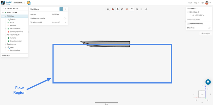

Then, I’d also advise you not to go for a Multiphase study, at least not until you are a bit more familiarized with SimScale/CFD. You can instead try a single phase Incompressible study by creating a flow region similar to this:
