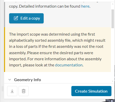

From what I see in your project and what I understand from your question, are you saying some solid parts representing welded region are missing in your project?
This could be because they were not defined in the same assembly file in your CAD tool. If you click on the geometry in your project, you can see the below warning message:
Have you checked out how to import assemblies into SimScale yet? You can also check out this additional, slightly more detailed article about the same.

Hello there ! Richard here! Could u let me know if we could add welds here, in simscale, Cause the link u shared didnt help much
With our CAD MODE, you can ‘pre-process’ or make small changes to your existing model to make them ready or prepare them for the simulation you choose to run. However, you cannot model any new parts. That you would have to model and import from your preferred CAD software!
