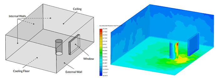

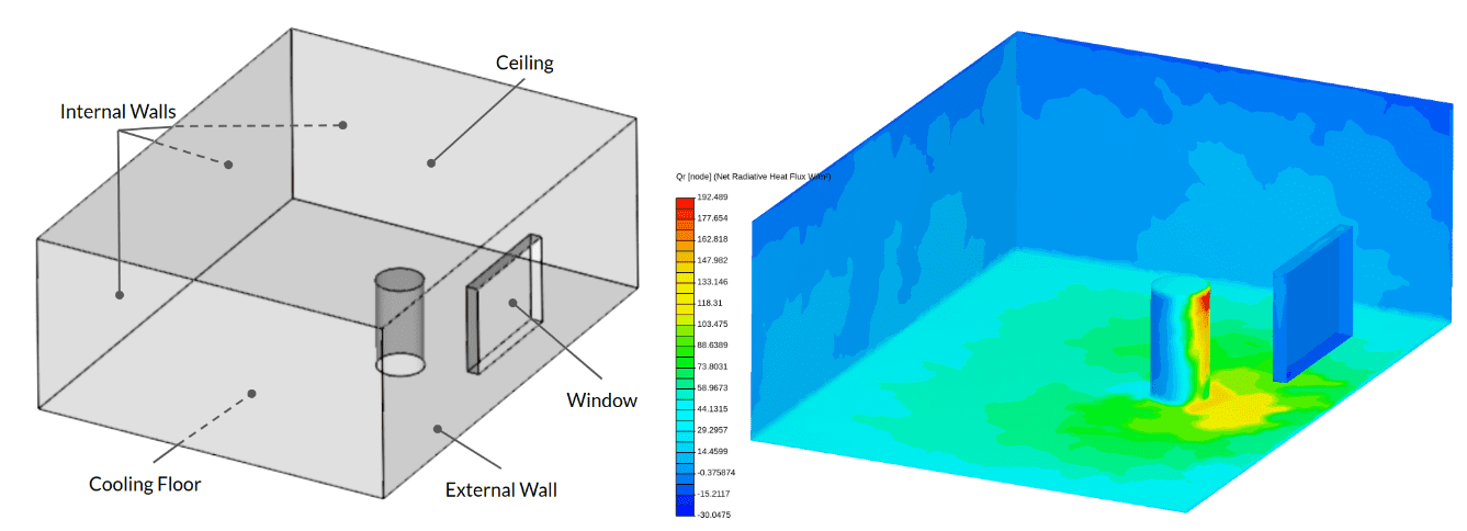

On the SimScale platform site, I can suggest you have a look at this article on how to set up different wall conditions.
You can also have a look at this tutorial, it explains very well how to set up an indoor room, with the different Boundary conditions for concrete walls and windows.
