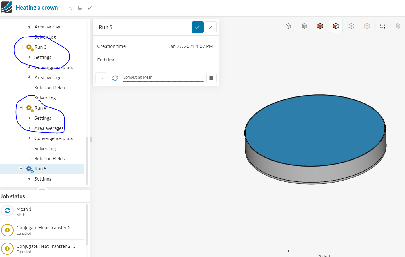

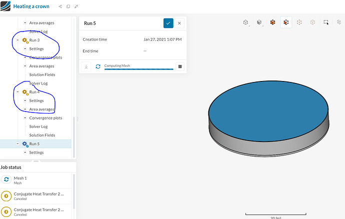

I continued my simulation but, today, the I think that all is doing well but the time the simulation takes is very long so that, all of them (runs) failed as you can see through my screenings.
Hi there, I hope you are doing great!

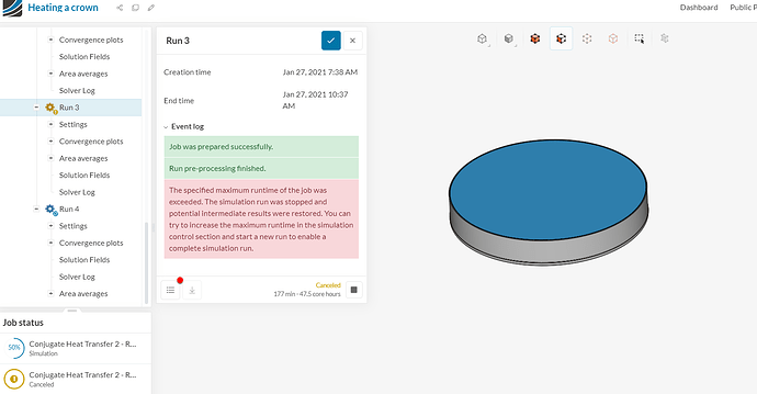

This is the error message that indicates the cause of the cancelation: “The specified maximum runtime of the job was exceeded. The simulation run was stopped and potential intermediate results were restored. You can try to increase the maximum runtime in the simulation control section and start a new run to enable a complete simulation run.”
This is because of the ‘Maximum runtime’ input you are currently using, on the Simulation Control tab.
This is real-time, and after it passes, the simulation automatically stops. Right now it is set to 10000 sec, which is about ~3 hours. I suggest you set it to 30000 instead This is also the maximum you can simulate with the Community Plan for a single run.
