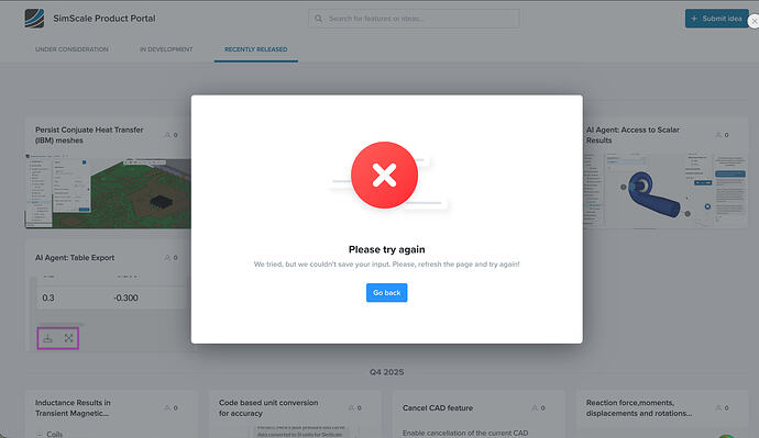

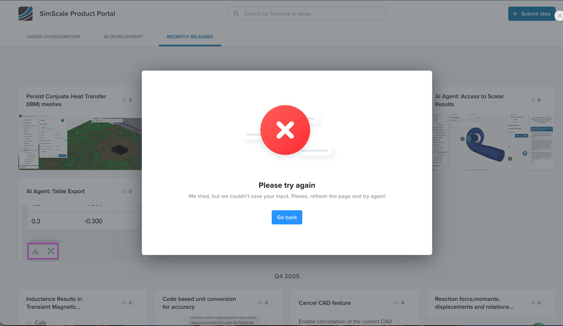

Hey, Bryan. Happy to do that, but when I tried, I kept getting an error that wouldn’t save the
idea submission. Will try again later, or I can email it. Let me know!
Hi @mcrushing
I can reproduce the issue on my end and have reported it to the team. In the meantime, I’ll go ahead and submit the idea for you.
