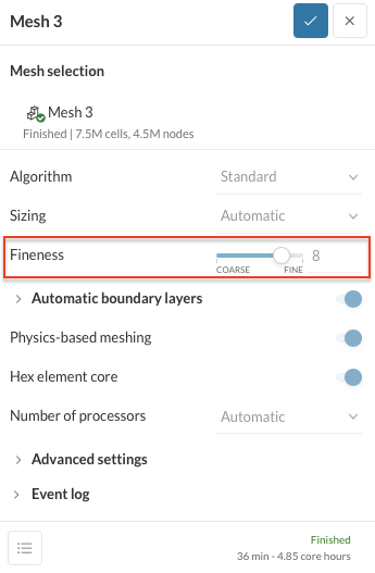

Thanks for posting your question. Have you are tried using mesh Fineness as 3 instead of 8, for example? It might be helpful and the fastest way to get it.

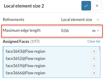

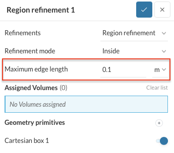

I also would change the refinements to something like this:
Please give a try and let me know if this helps.

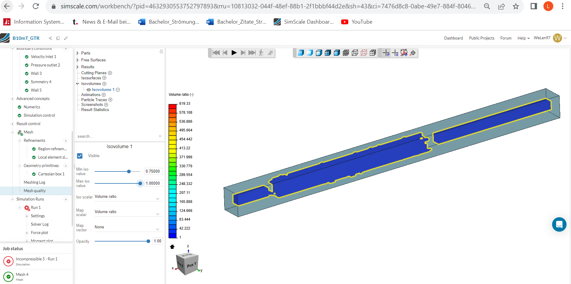

Hey, I read the artical but I am not smarter about what to do. Can you please help me. I send a picture how it looks like.

Can you explain me please how I have to interpret my picture I sent. In the example it is only a bad mesh at the end of the wing and when I anaylse it, it’s the whole mesh. And I couldn’t figure out how to change the bad mesh.
