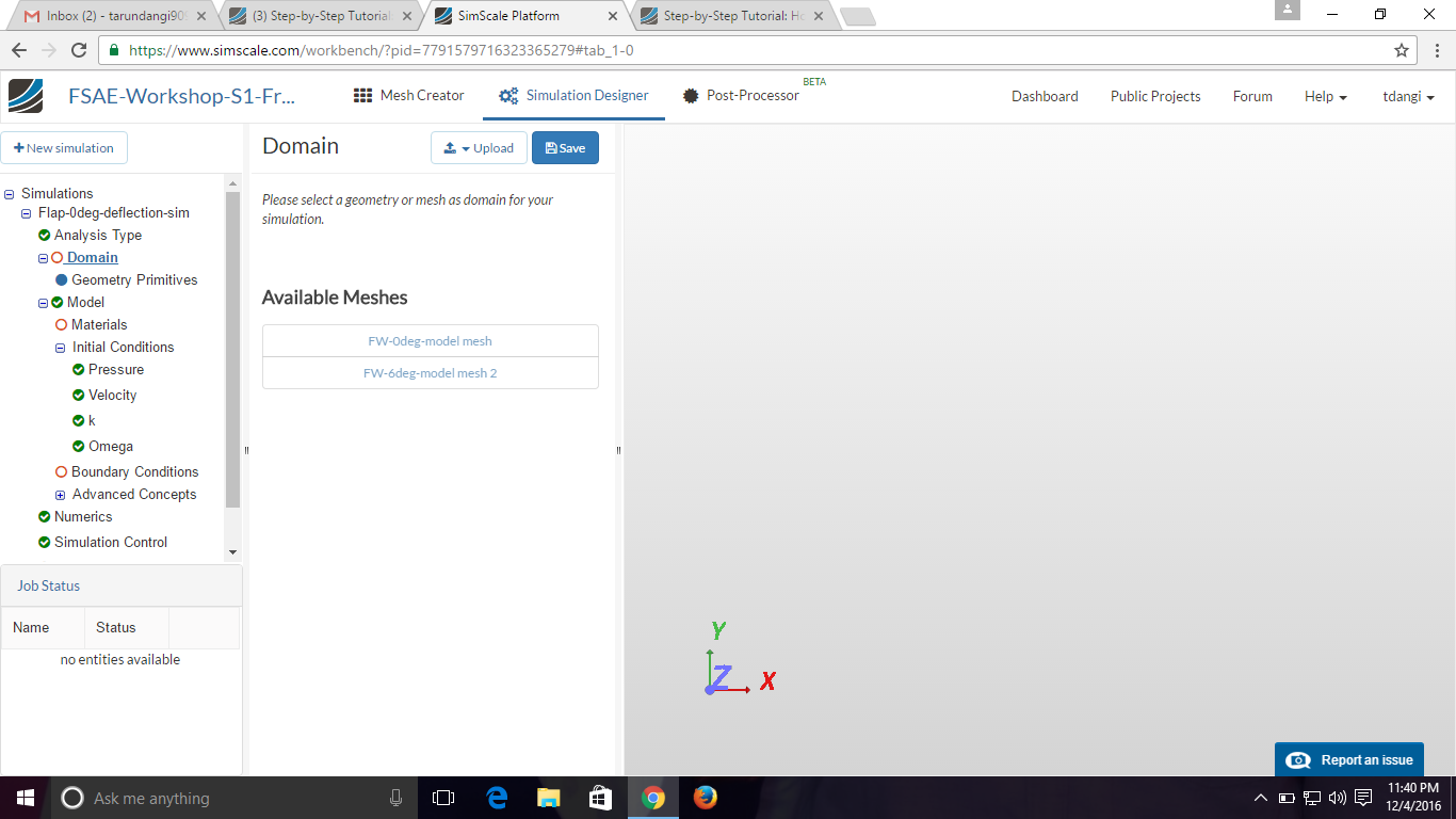

The operation on the Mesh 18deg it’s finished but on the simulation designer I can’t choose it, it’s the only one I have the problem with. Any answer?
Good morning @debroy84863568: I increased the cores to 16 and the meshing process was successful!
Try it again with 16 and let me know if that also worked for you!

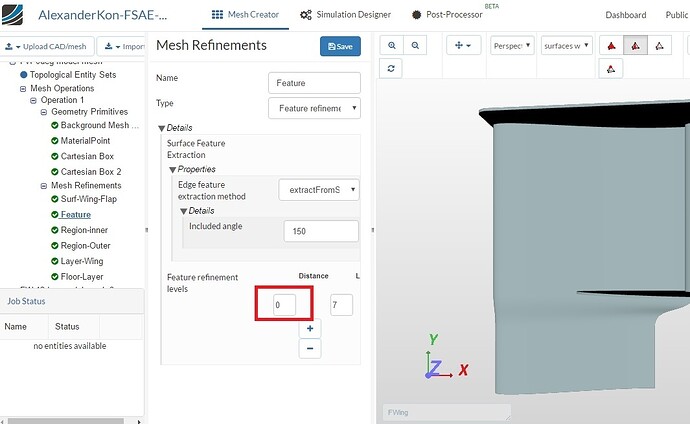

Hi. Thank you for the responce .
Unfortunately i couldn’t keep up more yesterday .
I am restarting now .
Here is the link . https://www.simscale.com/workbench?publiclink=6180bf16-d10c-403e-b72a-bb7bf7aba531

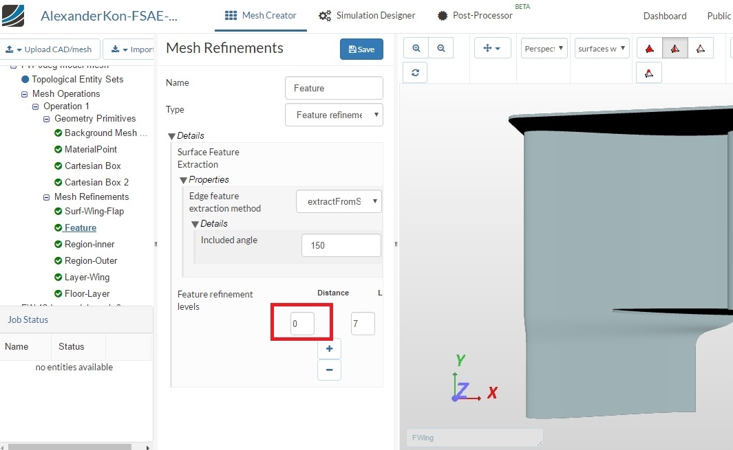

Hi @AlexanderKon,
you have a little mistake (see picture). Make sure you set the Feature Refinment Levels from 0.001 to 7. Change that and try submitting your job again!
Cheers! :slight_smile:

Thanks for the correction . Haven’t noticed because in the picture is like ( 0.00) the third digit isn’t very visible .
Now , i i tried resending the the first mesh only , with the changes , but nothing yet .
One mesh from yesterday succeded to finish the computation , specificaly the last one 18deg 10mm up , but had the mistake you mentioned also . I change the setting and save it . Do i have to resend it for computation ? Or try experimenting in simulation as it is . ( i don’t think i will manage finish the homework on time eitherway ) .
plz check it.
Hi @AlexanderKon,
no problem. Yes that is true but it was mentioned in the text. I also tend to look at the pictures only and ignore the text sometimes :wink:
Yes, you have to change your settings then submitting a new meshing job.
