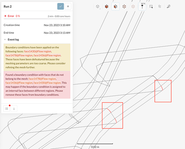

Everything made sense and worked fine until I reached the 5th point in the tutorial where “the simulation starts”. I get this error and don’t understand how to interpret it. I’ve tried creating a new mesh with “fine” instead of “moderate” as the tutorial prescribes. But this didn’t seem to solve the problem.
Error message with moderate mesh:
"Boundary conditions have been applied on the following faces: face1430@Flow region. face1478@Flow region, face1436@Flow region. These faces have been defeatured because the meshing parameters are too coarse. Please consider refining the mesh further.
Found a boundary condition with faces that do not belong to the mesh: face1478@Flow region, face1436@Flow region, face1430@Flow region. This may happen if the boundary condition is assigned to an internal face between different regions. Please remove these faces from boundary conditions."
After updating the mesh to “fine” the face’s 1436 and 1430 were resolved. But I keep getting an error with face1478.

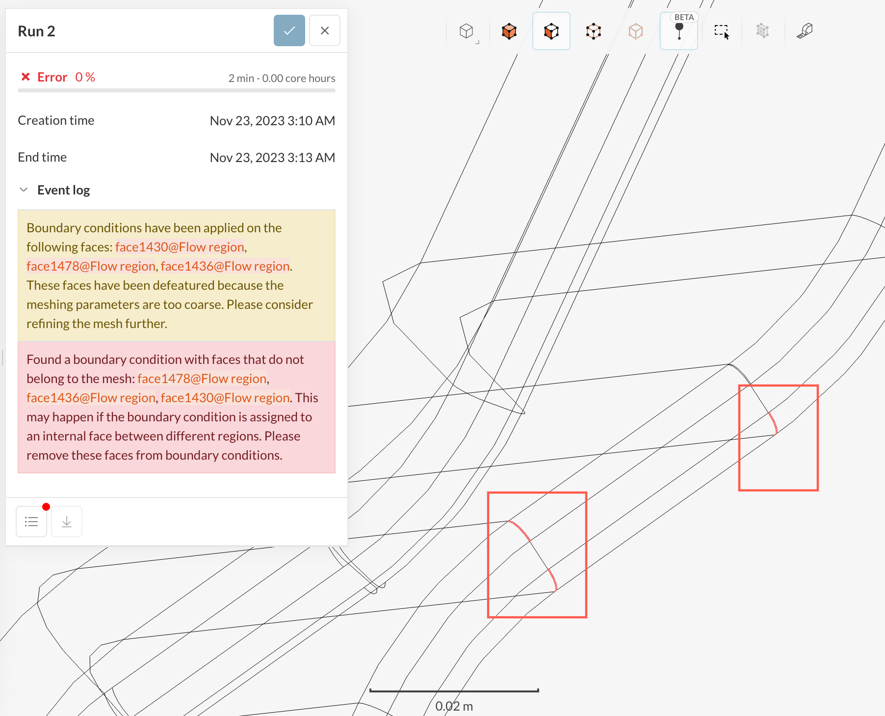

Hi there,
These are the faces that are creating the error
You can simply remove the boundary condition for Spoiler where you assign no-slip condition and it should work perfectly!

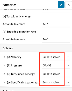

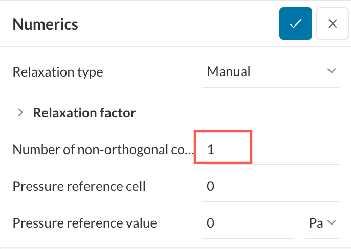

You can also set the Numerics settings to the following
Your simulation should work now :slight_smile:

I don’t think I quite understand how and why removing the boundary condition for the spoiler should help? Don’t I need the boundary condition for the spoiler as the tutorial prescribes? As said, I’m new and a little confused :wink:
I tried changing the numerical values to your suggestion. But this didn’t resolve the simulation run error, the same error appeared (run 4).
