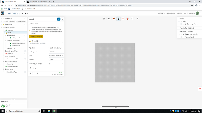

Simulation assignment on the geometry is not supported for the currently selected mesh
I am very new at Simscale and am not fully understanding what this (below image) means and what I have to change in order for it to create a mesh for my geometry. I am currently working on a wing design for a fluid mechanics course and need to compare theoretical lift/drag forces and coefficients to CFD results. Not sure what is wrong with my part, or if I can select the mesh as my simulation domain without introducing any errors.
Thank you,
Josh
[https://www.simscale.com/workbench/?pid=2624103650231969576&mi=spec%3A17ce6990-5900-4a49-8509-ef9dd48604d6%2Cservice%3AMESHING%2Cstrategy%3A2&sh=1]
Your mesh did finish (expand Event Log to see its stats).
Just click use ‘Use mesh as domain’ and you should be OK from there.
You have to click that each time you make a new mesh.
Thank you very much. Was not sure if choosing it as my domain would give me incorrect data.
