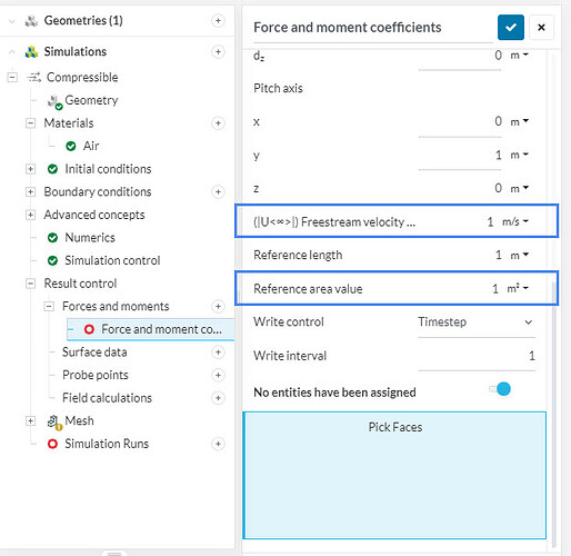

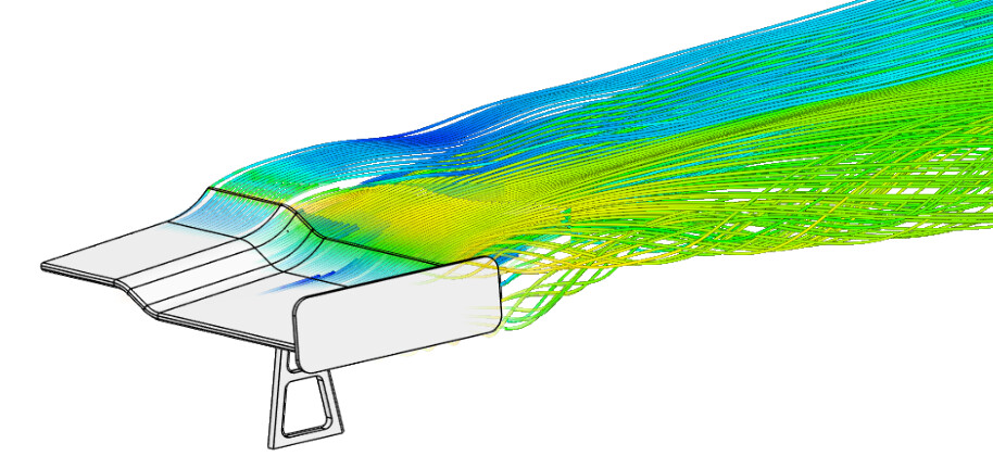

I made rarzorcrest themed flying boat and was quite pleased by the looks of it so i tested it in soldiworks, ironed out the faults i could find and then put it here to have a little higher accuracy.
Though now im doubting the results are way to good, the lift seems fine but the the drag seems very low (expected around 6000 N and got 3880).
I would appreciate if anybody could have a short look and tell me what i did wrong and how i could improve the accuracy.
