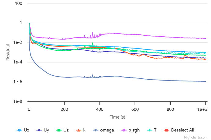

I am currently using SimScale for my academic research related to Computational Fluid Dynamics (CFD) simulations, specifically focusing on transformer cooling system/radiator design optimization.
At this stage, my simulations are still running and have not yet converged because the pressure residual (p_rgh) has not reached the required level below 1×10⁻³. Consequently, I require additional simulation time to achieve the necessary convergence and ensure reliable results.

Hey @210102061 ,
Did you take a look at your mesh quality. Here is an article helping you to dive deeper into your mesh quality and possibly help with convergence:
Other than that, you can take a look at the below article for all the parameters at which you can take a look to check if a simulation is converged, in general:
