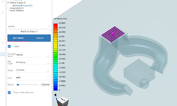

Can’t produce any traces from the seeds placed over the intake. There are traces produced if I place the seeds randomly on the enclosure.
Also, using isovolumes to have a velocity mapping shows what I would expect… so, the CFD calculation seems to be correct, except the particle tracing won’t produce any visual results.

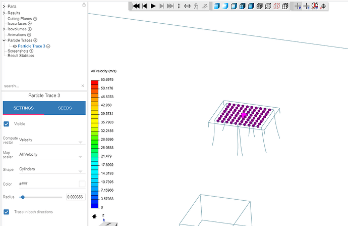

To reiterate: please look at the image below: seeds are in place, but no traces being generated.

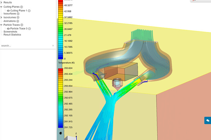

However, when I opened the project this morning, it looked like there were generated (but again, opening the results didn’t show them)
Traces not being generated from seeds:
This is what I could see when opening the project this morning:

I believe this is a known bug (see this thread for reference, with a similar geometry as yours).
@Ricardopg thanks mate! Creating a section plane just below my inlet and placing the seeds on it fixed the issue!
