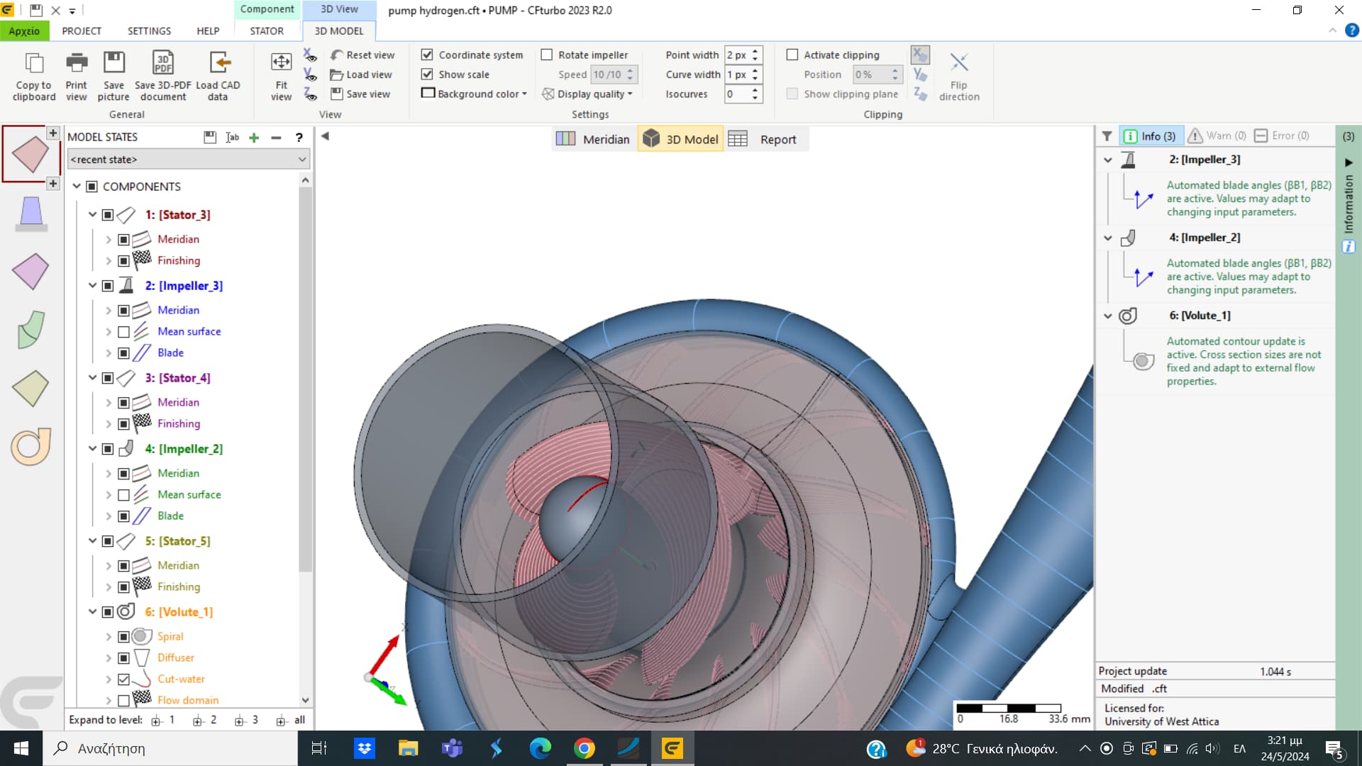

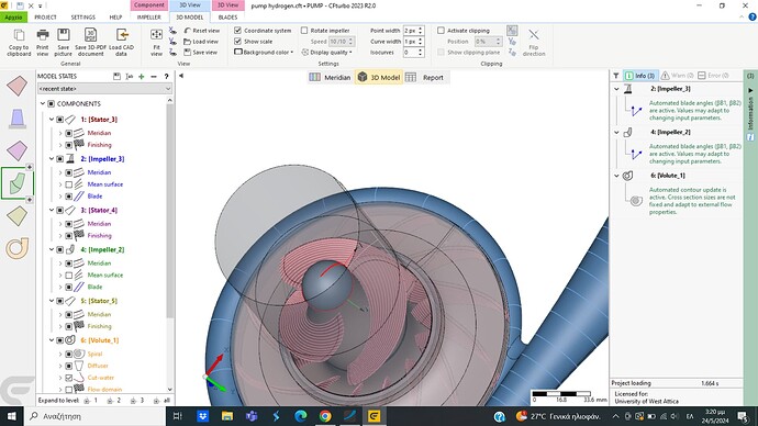

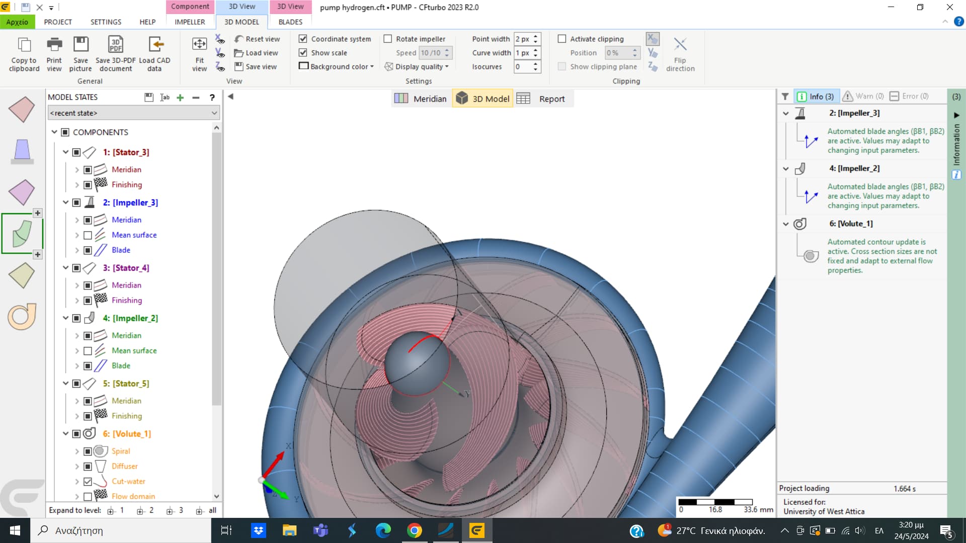

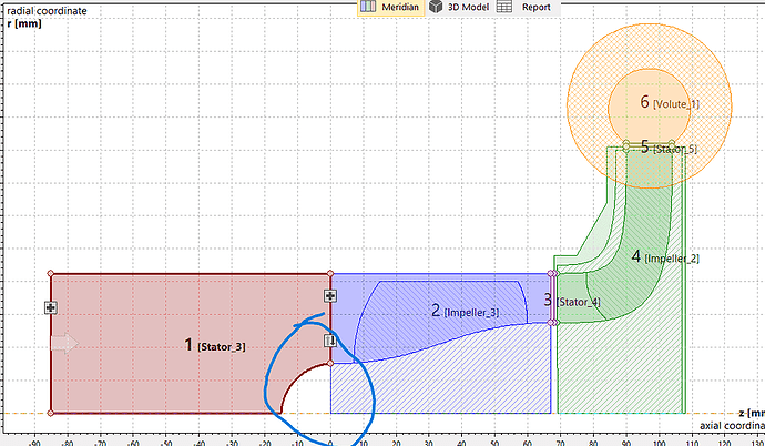

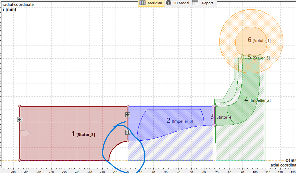

Of course.
In the first case
In the second case
These make no difference in the sphere. I want the sphere to be considered a solid material and not a fluid. Next I’ll set it as a rotating wall
Is it necessary to I difine solid material (second case) or It is not necessary (first case) ?

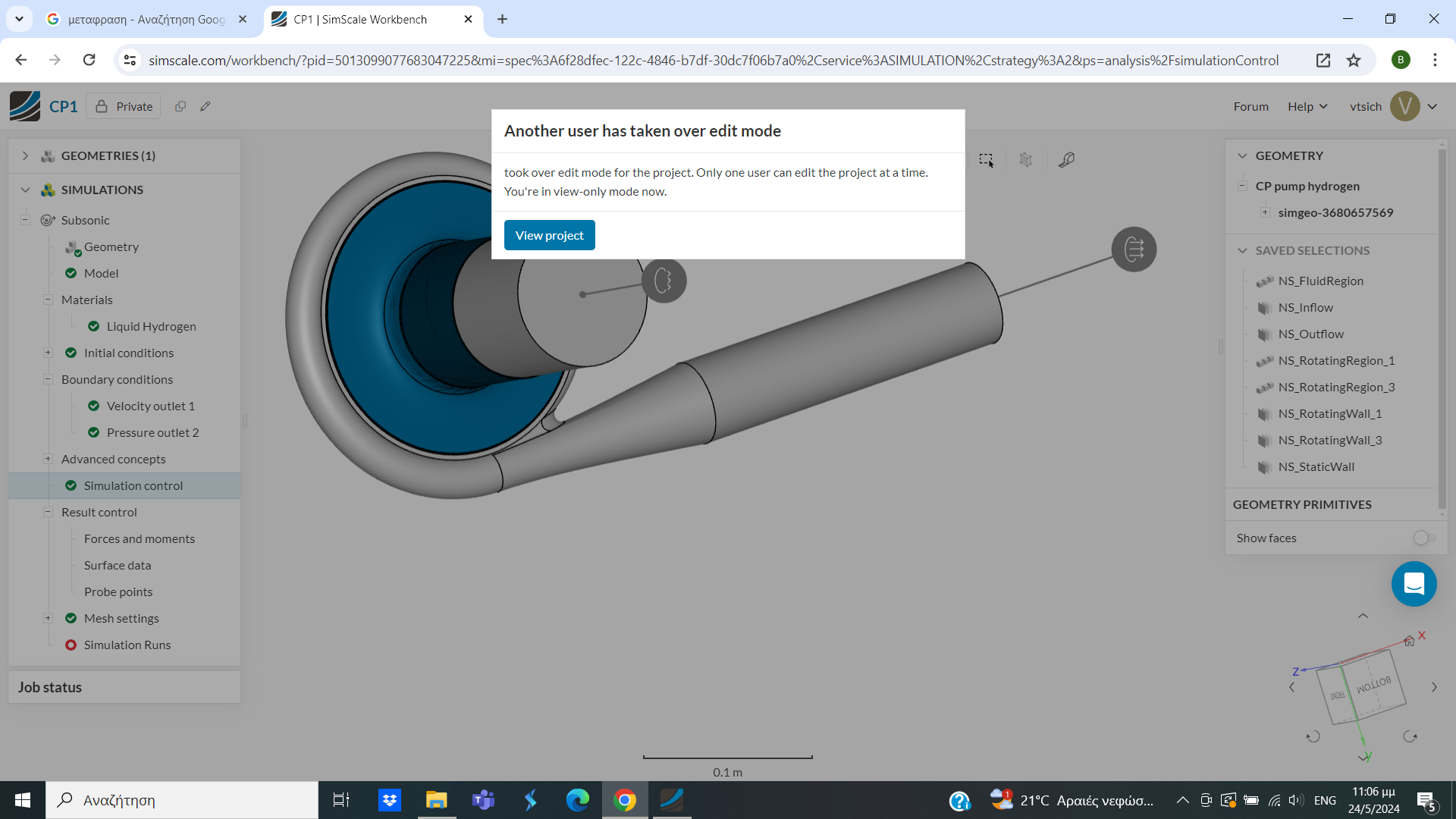

Unfortunately the sphere was not considered a material or a wall
I did it
I am doing a run at the moment for check
The sphere is fluid region which is problem

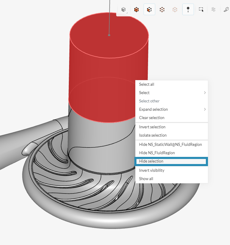

Hi @vtsich, I’ve just taken a look and it seems fine from a CAD perspective ![]()
The sphere is inside this cylinder, if you hide the faces:
You’ll be able to see it:
Ok. Thank you but I can’t put the sphere in rotate zone.
Yes, for that you’d have to model a rotating zone that includes the sphere,
However, if you wish to you could set it as a rotating wall ![]()
