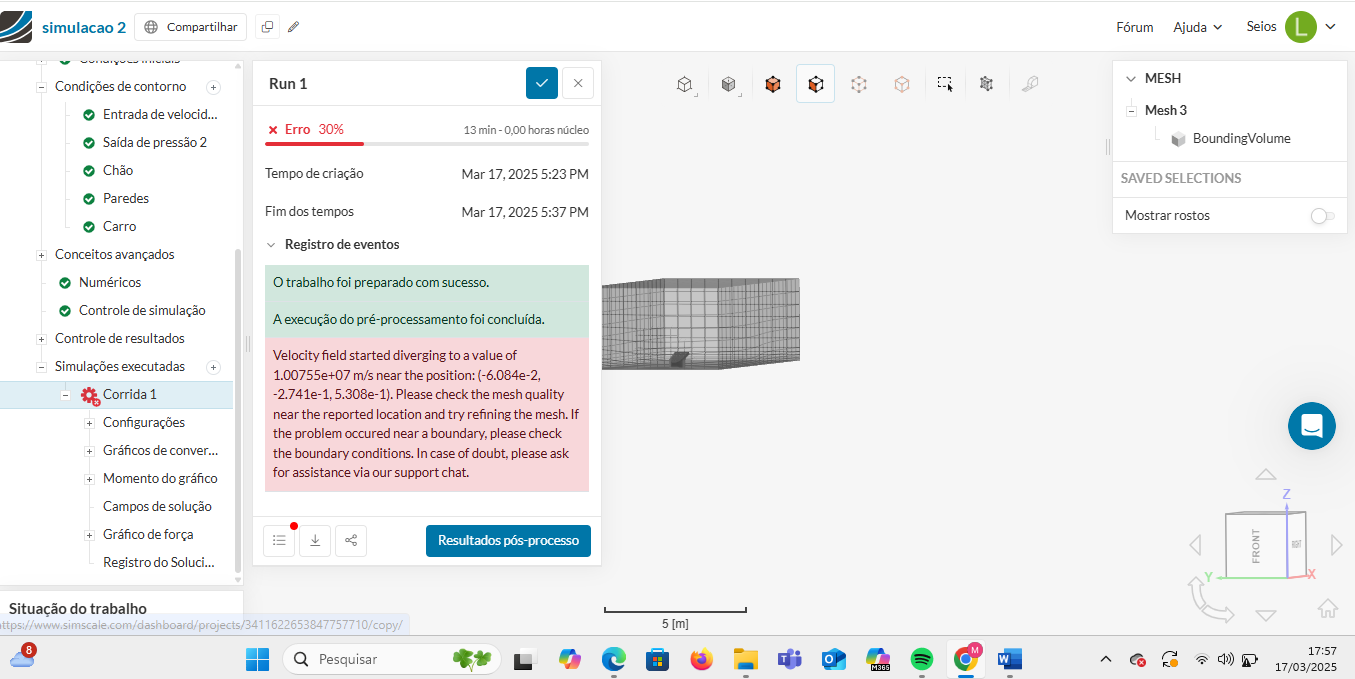

The simulations are for academic purposes, but I’m having a lot of difficulty because they don’t show any results.
Now I’m having problems with the mesh, it showed an error during the run.

This is actually a very common error in simulation, it’s called divergence. Divergence happens when the simulation is not converging to a final solution after each iteration - as it should for the results to be valid.
In that sense, we have some resources to help you spot where the issue is happening and potentially solve it:
- How to Check Convergence of a CFD Simulation? | SimScale
- Divergence in Simulation: How to Tell When and Where? | SimScale
- How to Check and Improve Mesh Quality | SimScale
Please apply the workflows described in these links and share with us the results you’ve found!
