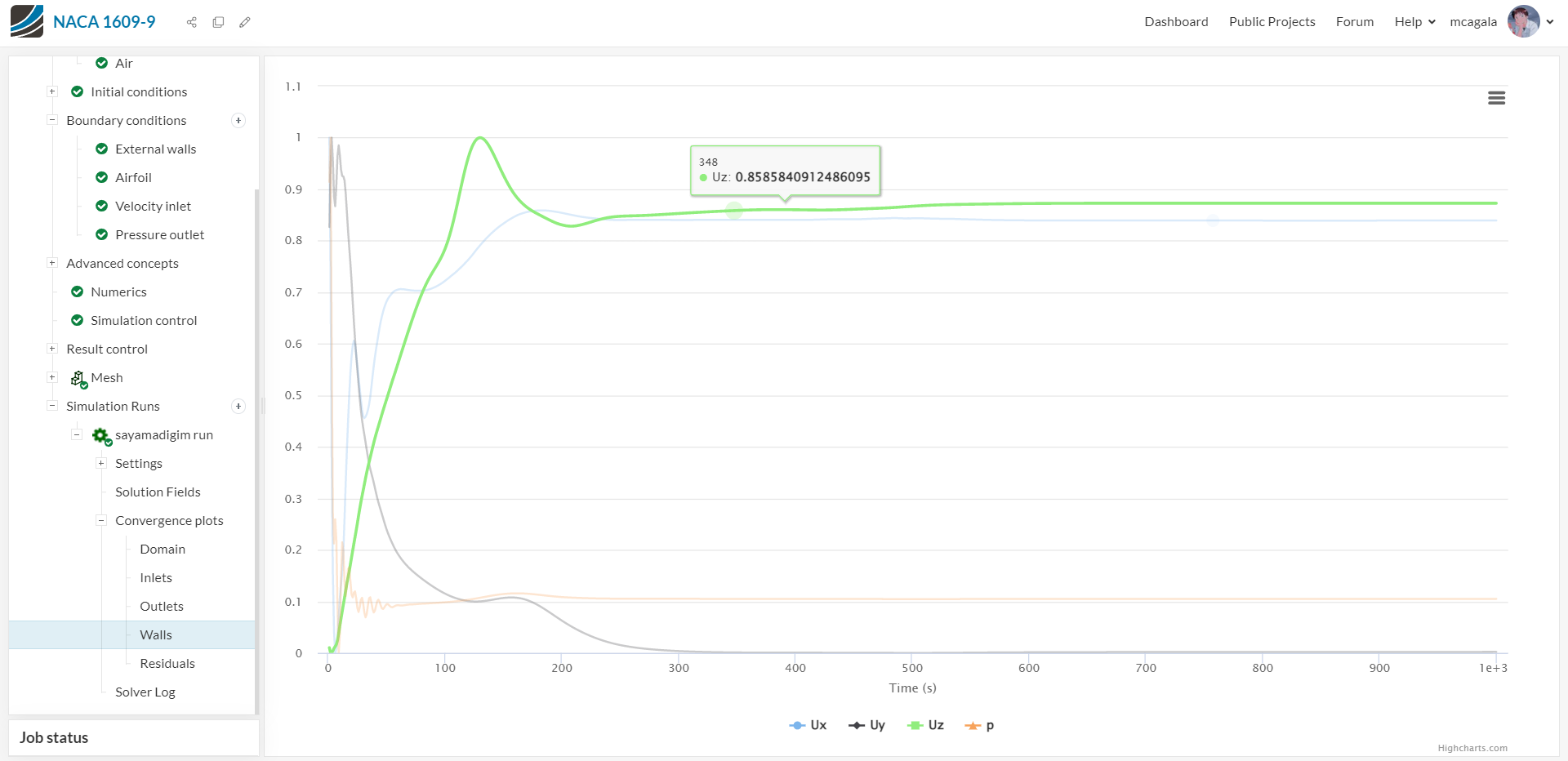

Thank you so much, I handled the situation about Reynolds number thanks to your advice. But I couldn’t understand the plots that I get. I want to reach lift coefficient and moment coefficient. How do I do that?

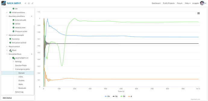

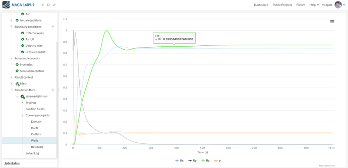

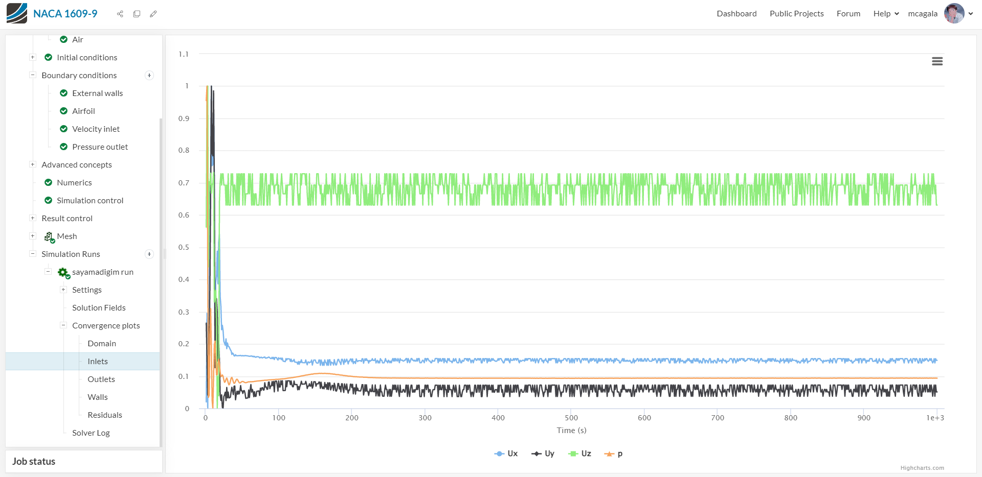

What plots are you receiving?
Please post a capture here and I can help you to make sense of it.
Hi!
You are showing me convergence plots. Show me the plot of the aerodynamic forces or coefficients so we know if you have converged values.

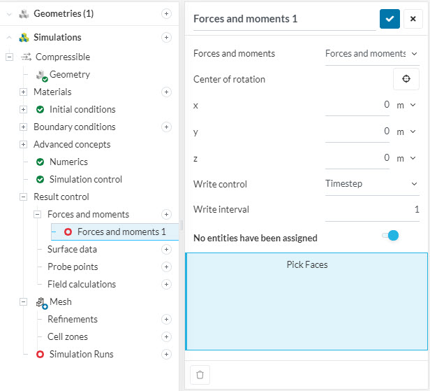

That is exactly what my problem is. I don’t know how to reach them in Simscale. And this force and coefficient plots are the main subject of my project which I am trying to reach.
Perhaps the following documentation can help you:
Thank you so much, I will try them.
