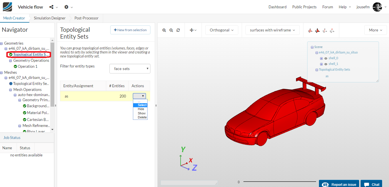

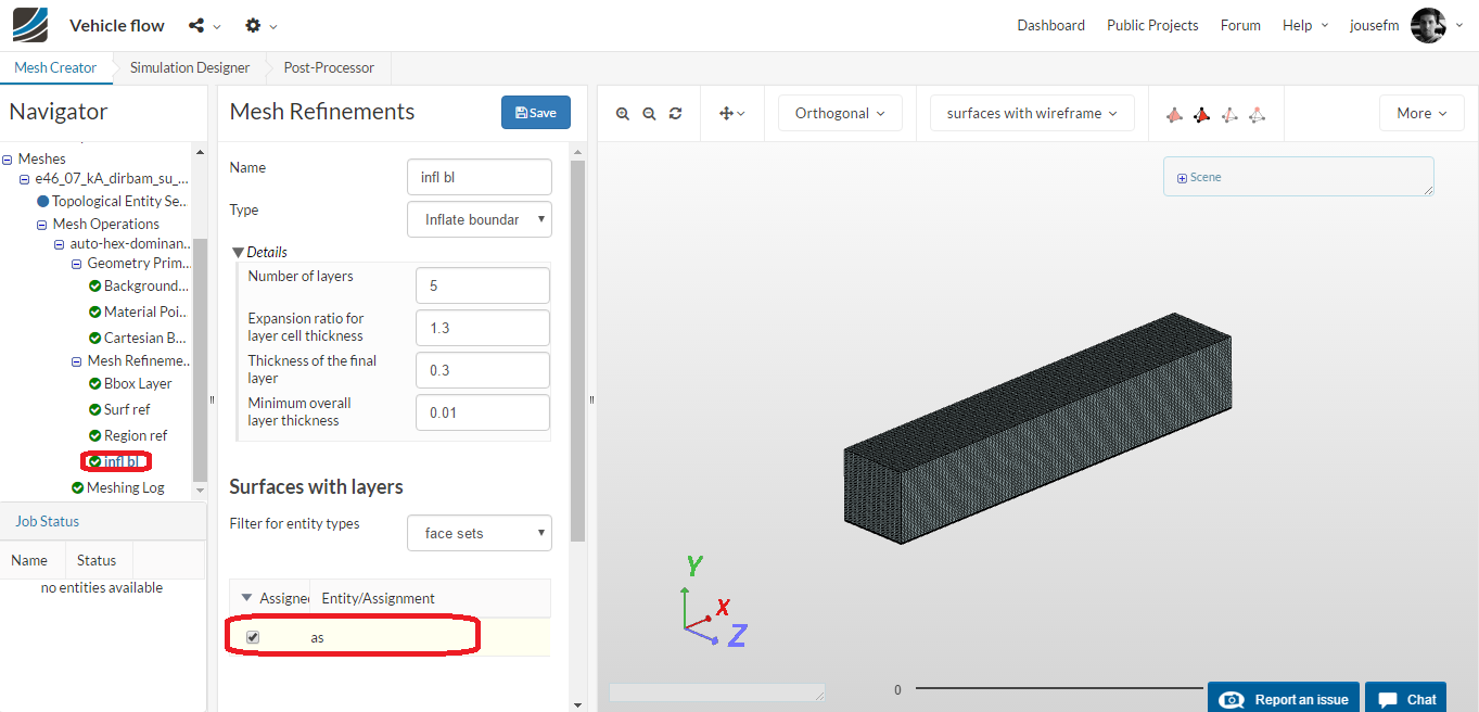

Hi @samuelshannons,
attached you will see that in the test project I have created a set with some faces saved as a Topological entity set
This entity set can then be used in any new Mesh derived from the same model:
Is that what you meant or did I misunderstand you?
