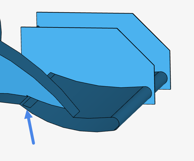

I had a look at your model and want to share some thoughts to reduce the complexity of your model.

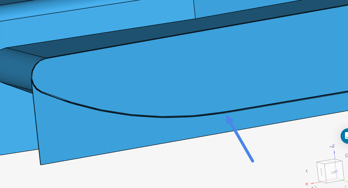

1.There are some faces at the rear diffuser which can be deleted as these are only splitting of the same faces
The small hollow section on the side diffuser can be removed, as this created a lot of small cells which increases the cell count.

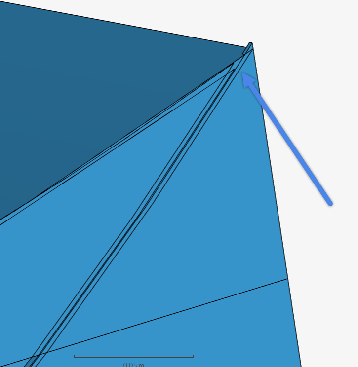

There seems to be a piercing face at the Front Wing which goes into the nose section.
Please try to clean up these sectctions.

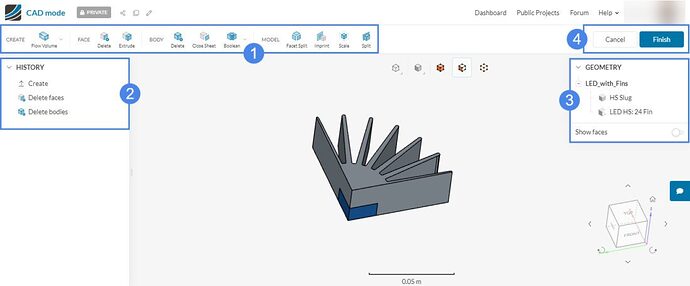

You should be able to remove all of these sections by using the delete face operation in the edit in CAD Mode as explained here:
