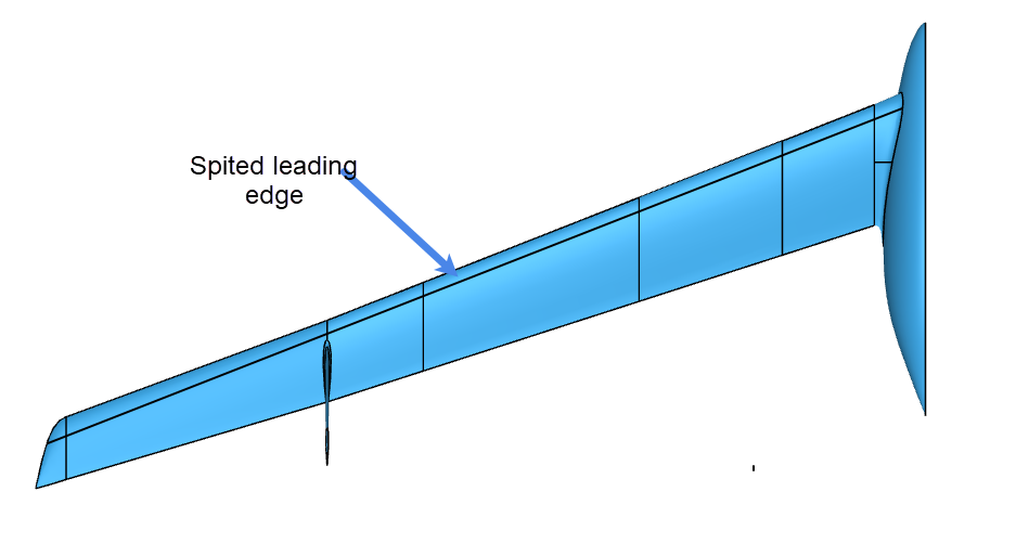

For your geometry, I would also suggest splitting up the leading edge of your wing, In order to assign a local element refinement here and a more coarse element refinement for the rest of the wing.
I hope these tips will help you.
