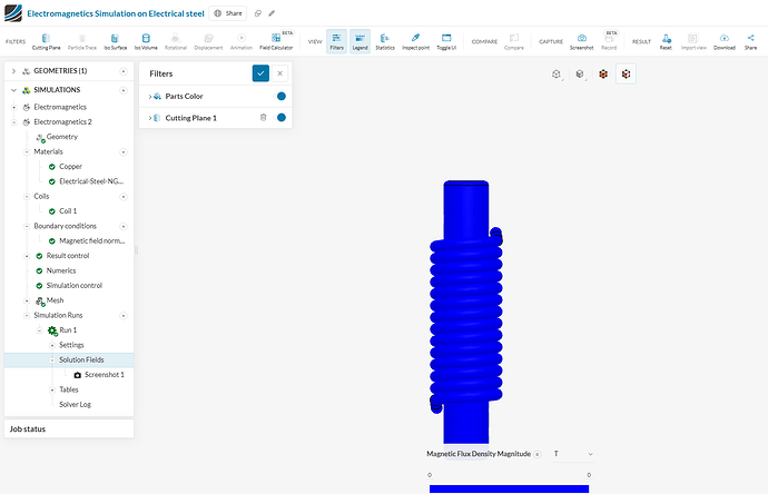

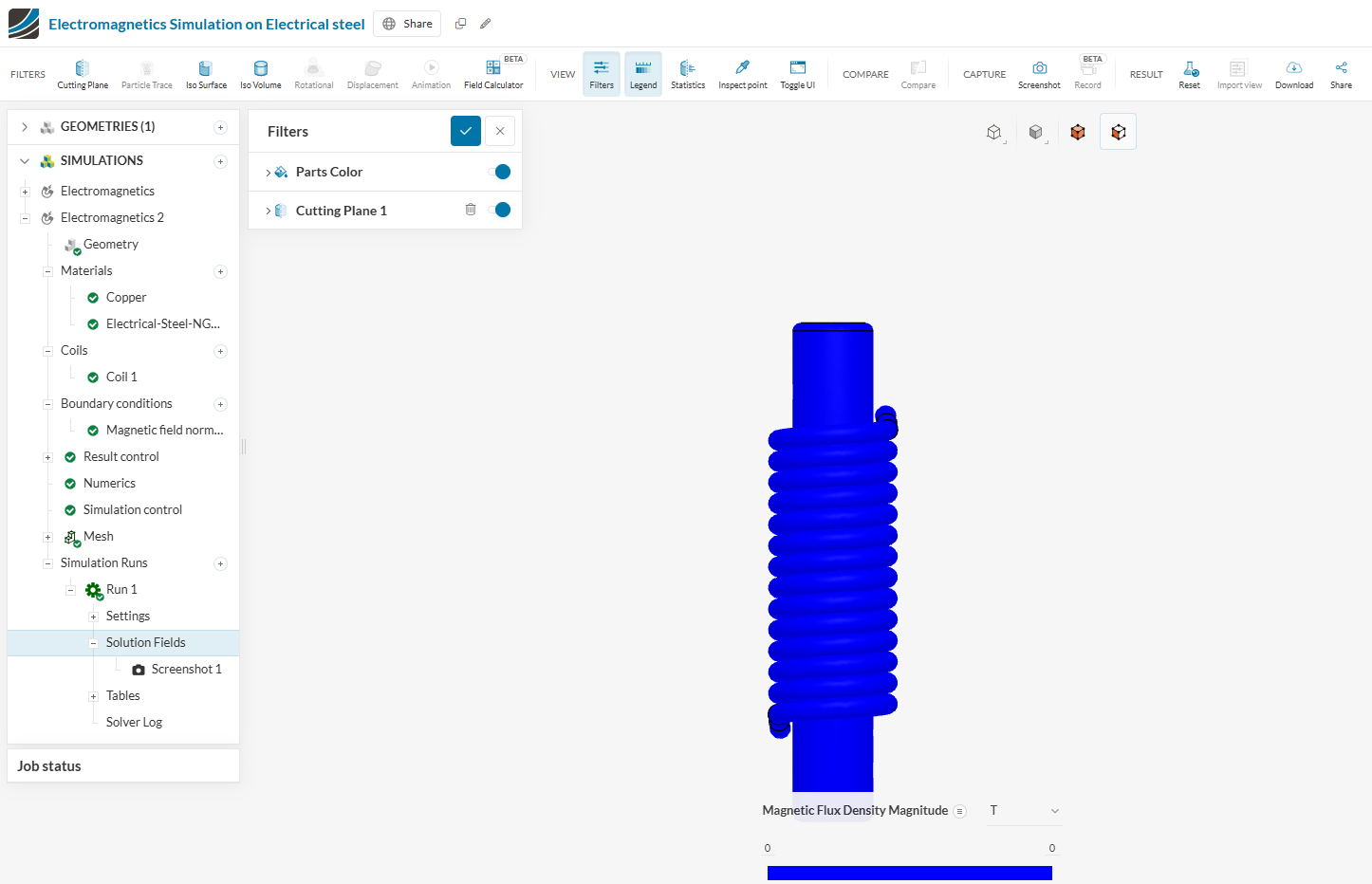

I’m trying to test electromagnetic testing for electrical steel
I tried to make the coil is the material from copper
and the column is made from electrical steel
there is no simulation is shown
please I’m seeking for help to run the simulation when I ran it does not give the analysis
Hi, for Emag studies you would normally create a flow region around the solid parts and define it as air. From your screenshots, this step seems to be missing in your project.
Make sure to check the Emag tutorials for further details: SimScale Tutorials and User Guides | Cloud-Based CAE | SimScale
