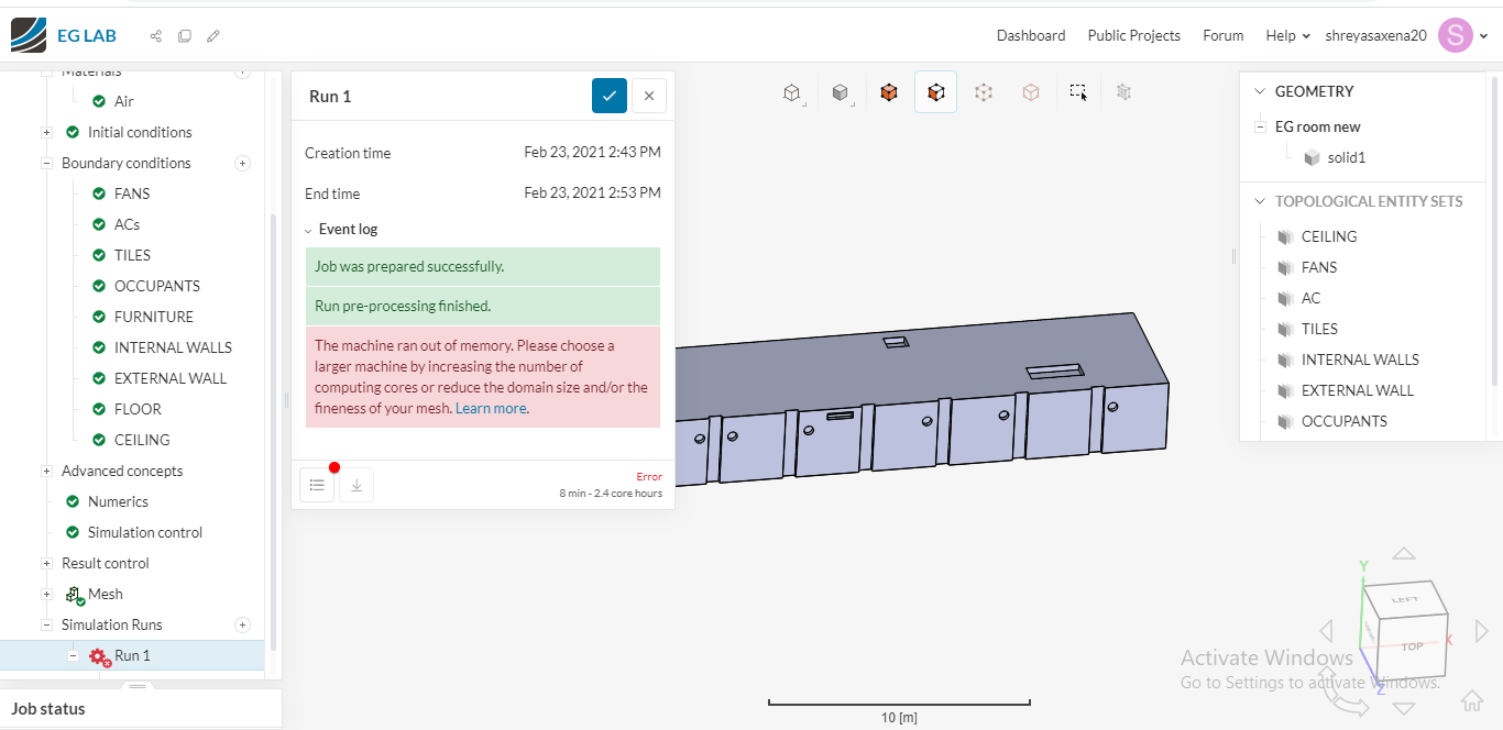

Error: Machine run out of memory
While running the simulations, it shows this, but on reducing the fineness, divergence problem occurs. Can you suggest me the fineness value so that this error doesn’t occur or any other changes?
Project name - EG LAB
Hi this is Fillia, thank you for using the forum!
This page states the possible reasons for this error, and tips on how to solve it: Error: Machine Ran Out of Memory | SimScale Knowledge Base.
My suggestion would be to make the mesh coarser, by reducing the level of fineness to 5. Give it a try, and let me know how it goes :smiley:
Yes, it worked.
Thank you!
