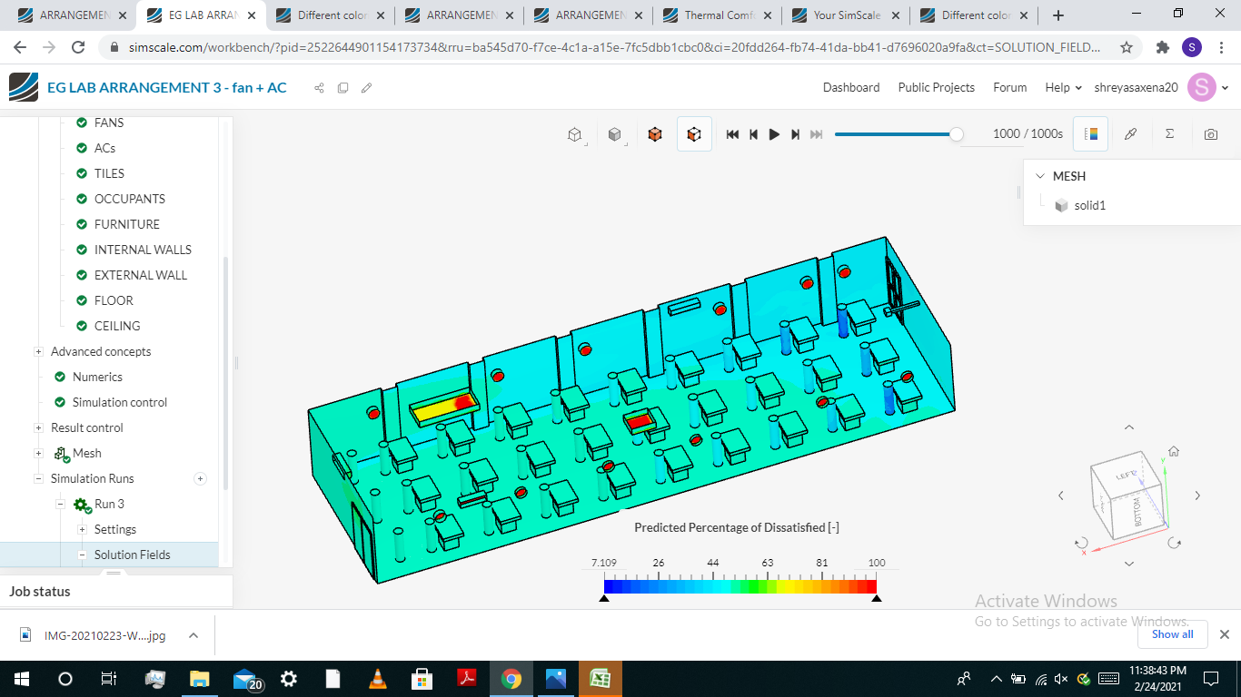

I have another doubt related to the same project. After performing simulations, I got the correct results but after refreshing, color of the parts has changed indicating different results. Can you tell the possible reasons?
Hey there, is it possible that you add some screenshots? There are many reasons why this could have happened, maybe a different timestep was displayed? Or the continuous scale was activated? Feel free to add picture so I can check

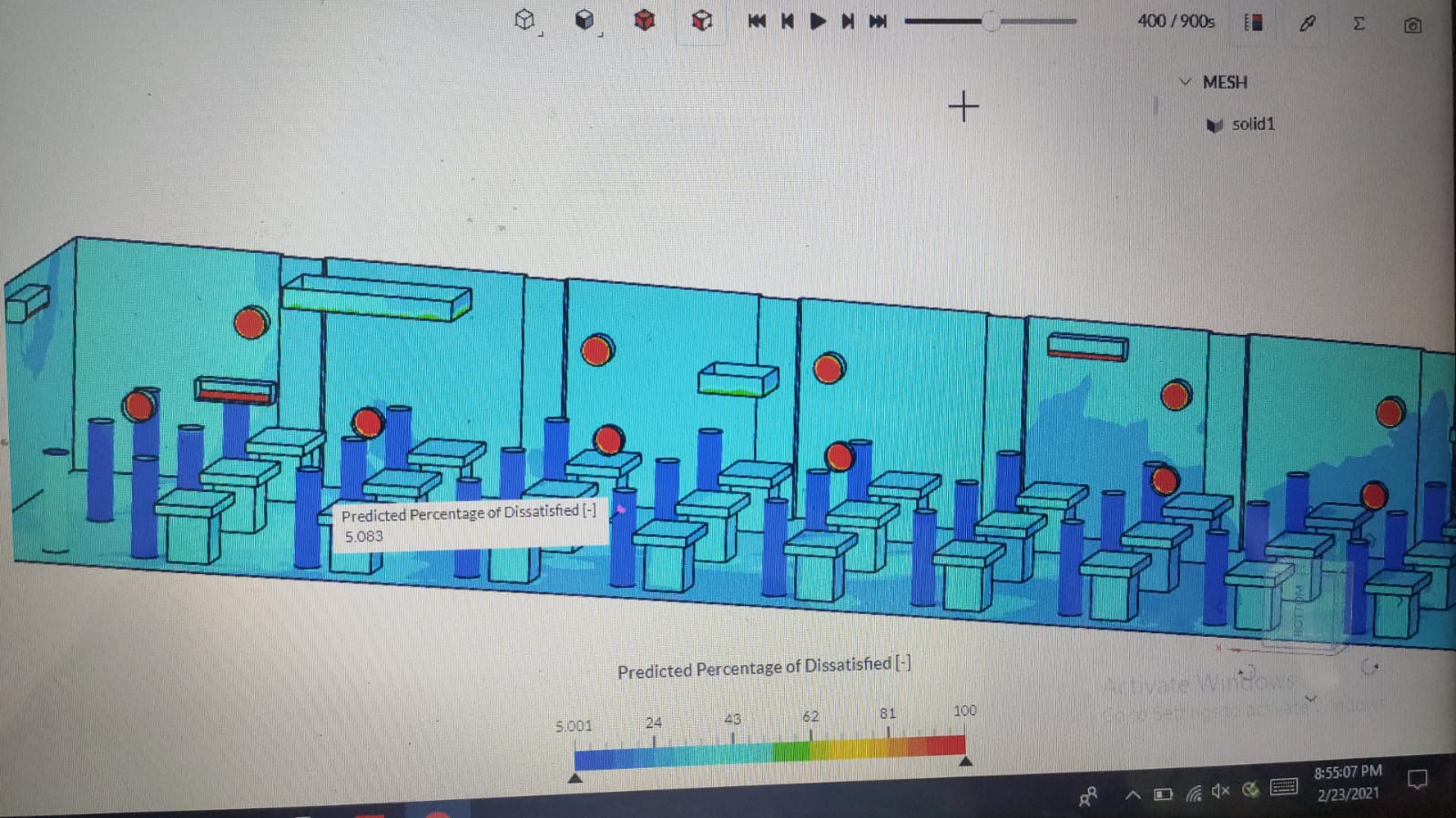

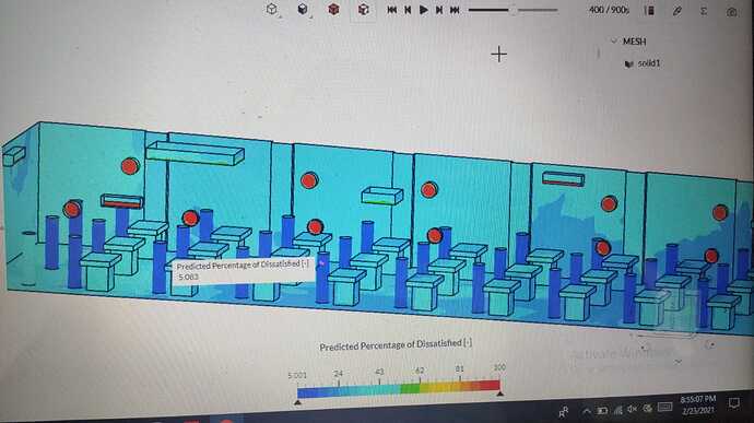

These are visualizations of the PPD at different timesteps:
First is at 400 loops:
Second is at 1000 loops:
So it is normal they do not show the same results ![]()
