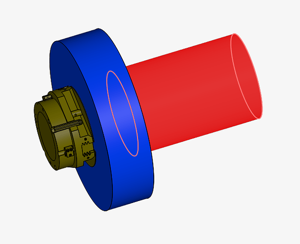

I have a hot block of metal, i bring a robot gripper nearby it (~100mm) for period of approx 10-20 seconds, then move gripper away again. I am not wanting to show this motion in SimScale. I want to represent the 10-20 second exposure time.
I am having trouble representing the 2x bodies, and the air gap properly. In the link above i’ve tried adding a ‘solid’ in place of the air gap because SimScale is not allowing me to simulate multiple bodies. I can’t give the solid same properties as Air, so I’ve (for the time being, to try to get ‘something’ working) set it as PP instead, which has similar k value and lowish density.
Regardless of this, the simulation seems to run for long time frame and the block of metal (300degC) transfers all it’s heat through the air gap and gripper part.
