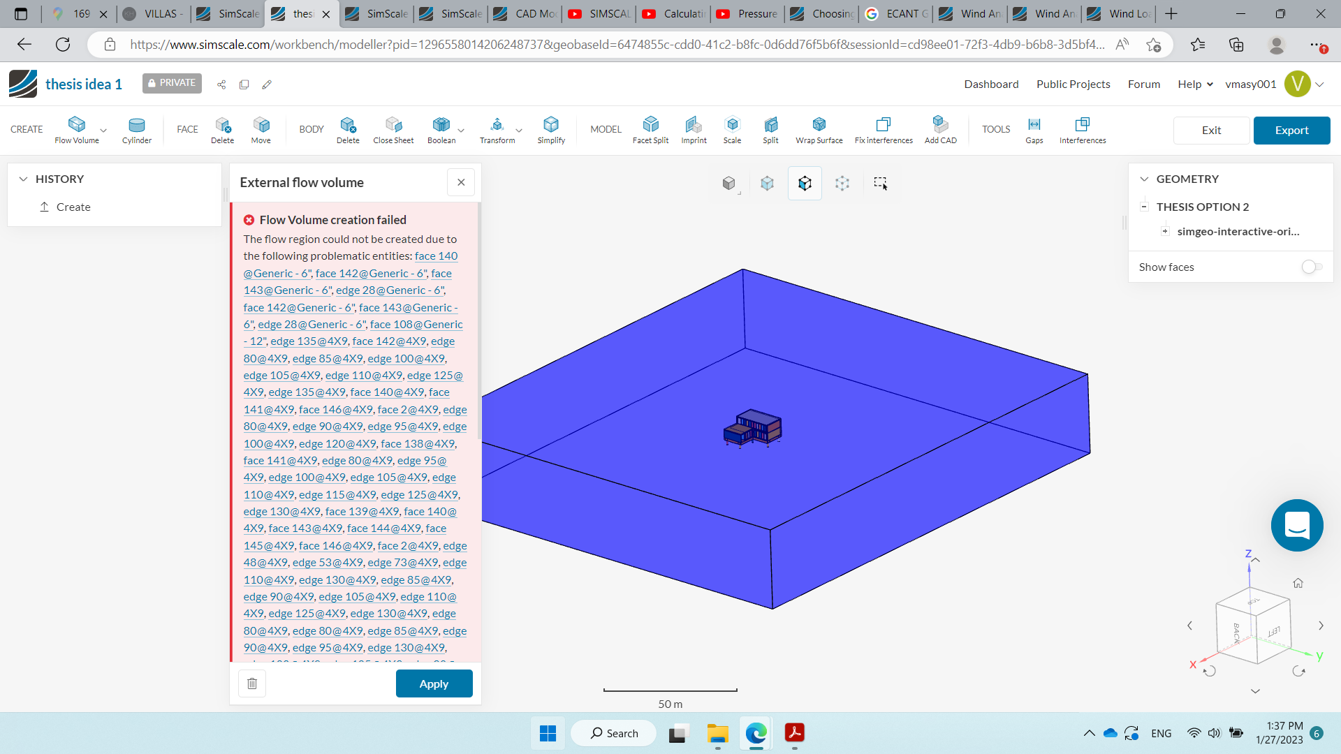

Trying to set up a wind simulation to see how the winds from a certain direction would affect the building/which parts get the most pressure on them.
For some reason, when I try to setup external flow it gives me errors. The model is imported from revit and only has walls windows and floors on it. It seems to have issues mostly with window frames but also some walls too.

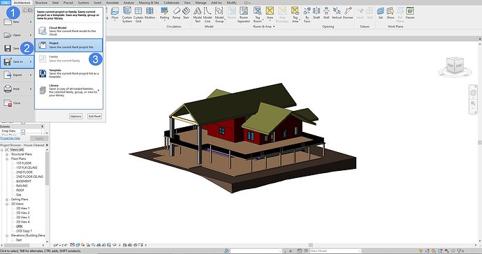

On the other hand, if you are using Revit, perhaps the following articles can help you:
thesis idea 1 | SimScale Workbench
would this be it?

I was also able to create the flow region by first doing a Surface Wrap on your geometry:
