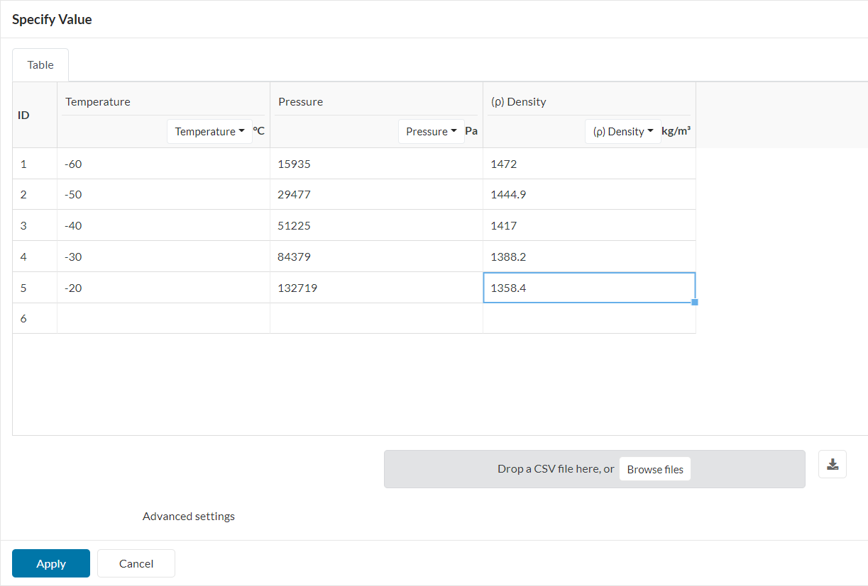

It is now possible to simulate with real-gas equations of state. Details on the physics and the setup can be found in the documentation article for Thermophysical Fluid Models. When choosing a real-gas you must provide data of the density and enthalpy as functions of temperature and pressure (see image below). You can also provide the viscosity as a function of temperature and pressure.

In order to use real-gas equations of state, you need to provide data on the density and enthalpy of the gas as functions of temperature and pressure. In some cases, you may also need to provide data on the viscosity of the gas as a function of temperature and pressure. This data can be obtained from experiments or from thermophysical property models.
Once you have the required data, you can input it into the simulation software and configure it to use the real-gas equation of state. The software will then use this information to model the behavior of the gas under the specified conditions.
