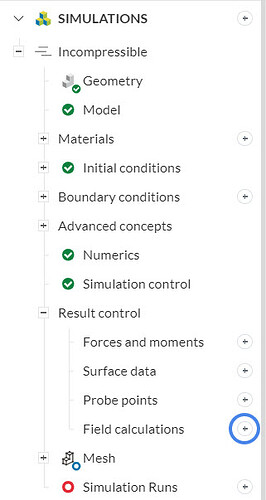

To include the wall shear stress you need to request the field before running the simulation:
After doing this and running the simulation again, the wall shear stress field will be available in the downloaded results.
