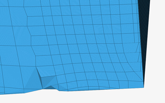

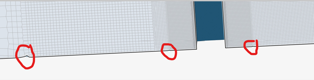

I created a mesh with inflation layers on the ground and on the building surface, When inspecting the mesh there are irregularities as seen below. Could someone suggest a way to improve this please, or will this not affect the results?

Hi ss02150,
maybe you can have a look at the feature refinement feature.
Sebastian
Would this not be used to refine the mesh surrounding my building, where as the issue lies in the areas highlighted in the first message?
You can use it to refine any edge area you want.
if you see that the bottom edge of the symmetry plane is not represented correctly you can of course use it there as well.
You just might need to split the fluid volume faces to create the feature curves.
