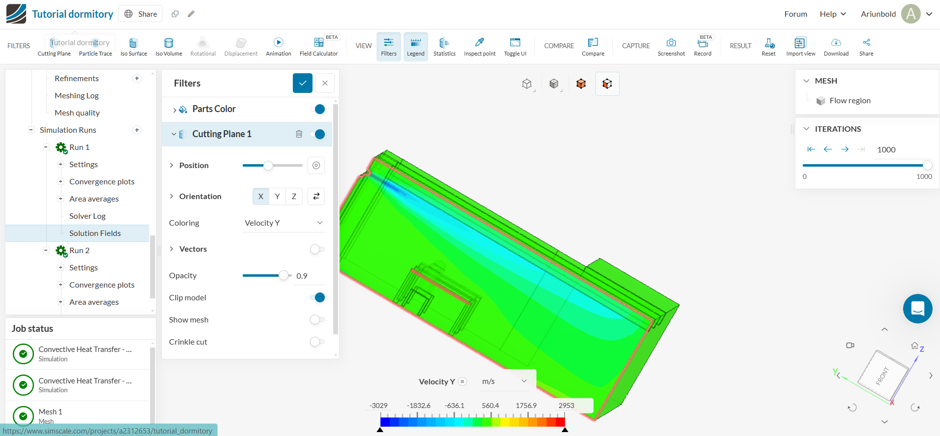

I tried to follow the tutorial [Meeting Room Thermal Comfort Analysis] using my model but the velocity is looking too high like hundreds and thousands of m/s. How should i solve this problem?

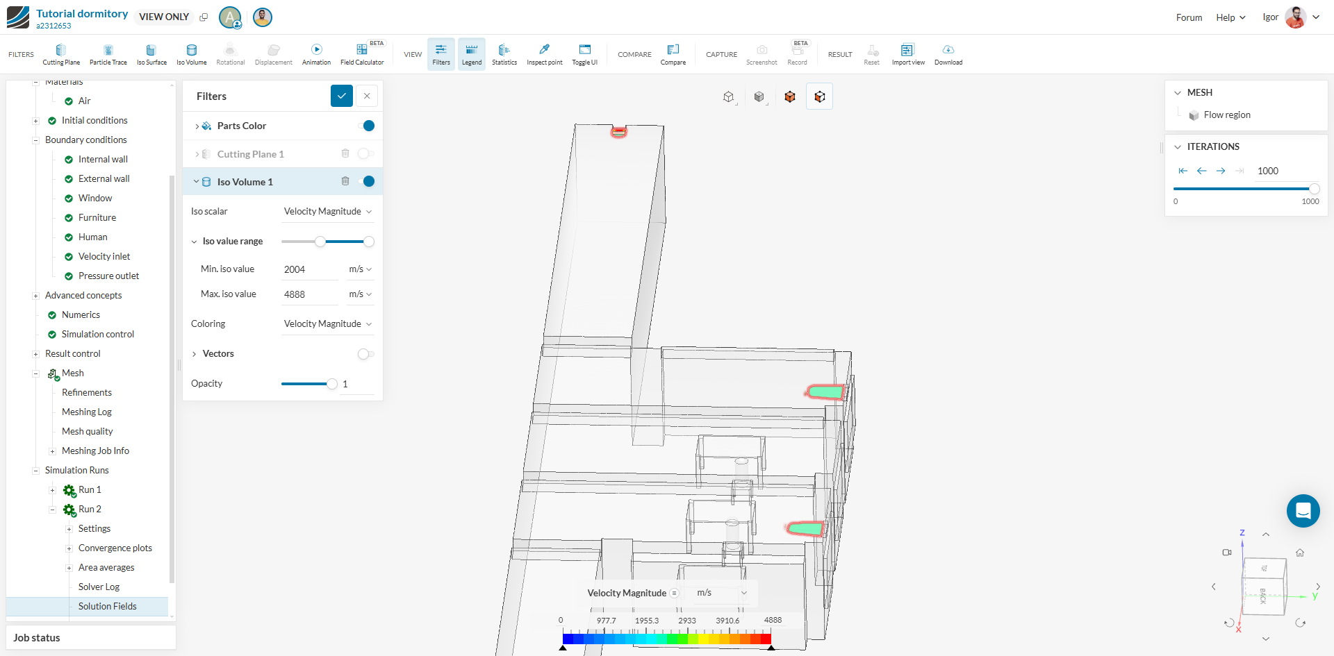

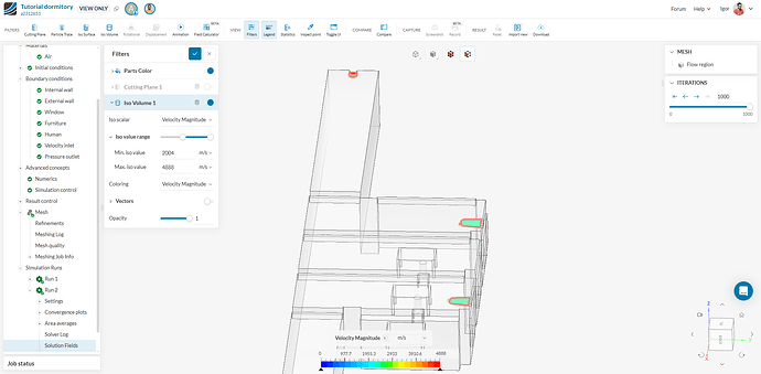

A first step in troubleshooting these sorts of issues is to apply an Iso Volumes filter to learn where the problem is coming from. I see it’s coming from your velocity inlets:

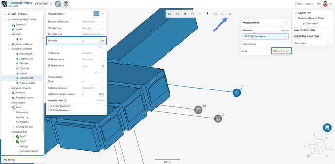

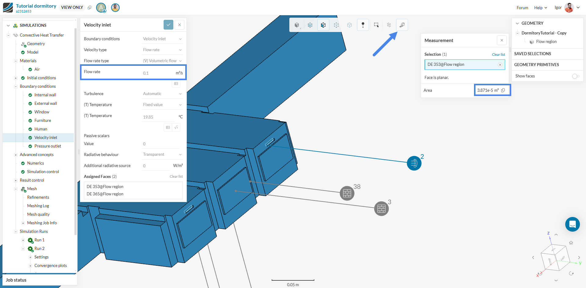

Then, I see you’re applying a 0.1 m^3/s flow rate to a 3.81\times 10^{-5} m^2 area face:
By using the flow rate x velocity relationship, the resulting velocity would be:
\dot{v} = \rho A v
if
\dot{v} = 0.1 m^3/s, \rho = 1.196 kg/m^3 and A = 3.81\times 10^{-5} m^2,
then v \approx 2194 m/s, which is a very large value and not feasible to simulate using any of our solvers.
