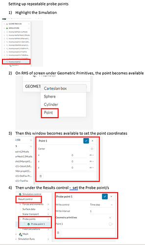

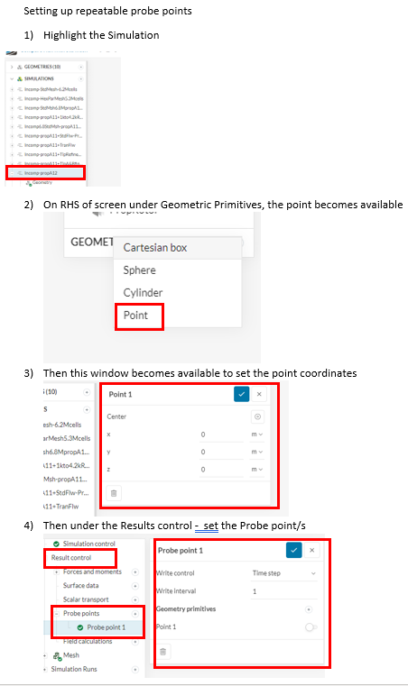

Hi luisdamaso
I don’t know if you are also aware of the ability to place points within the simulation to test for velocity etc.
You can create these probe points prior to the simulation by clicking on the heading of the simulation, then on the right hand side under Geometric primitives you can create ‘sample’ probe points so you can compare simulations for the exact same coordinate, but I do like the new integrated post processor as earlier mentioned by @anon41772514
Anyhow, you possibly know this already but if you don’t I hope this assists.
