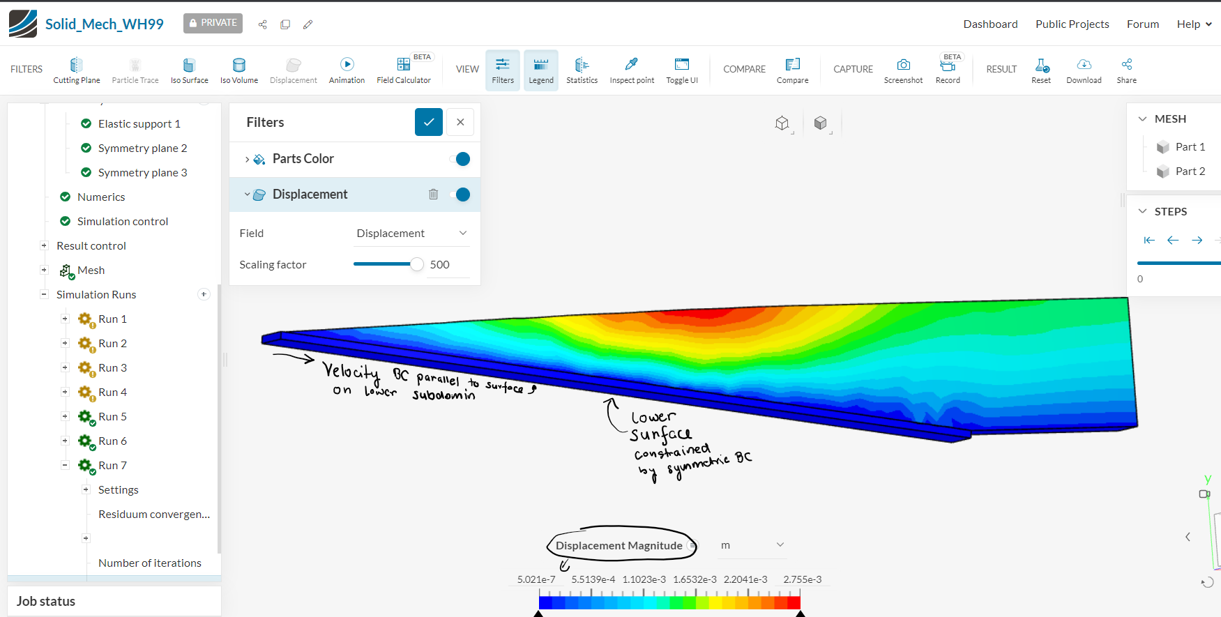

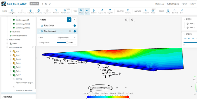

Indeed that was helpful and I tried implementing the same in my model. However the model subdomain doesn’t seems to moving the way it should. This refers to Run-7 of this model link.
In this model I constrained a rigid body (lower subdomain) using symmetric BC and applied surface parallel velocity, but the displacement seems to still be zero (pic below).
What could be going wrong here?
