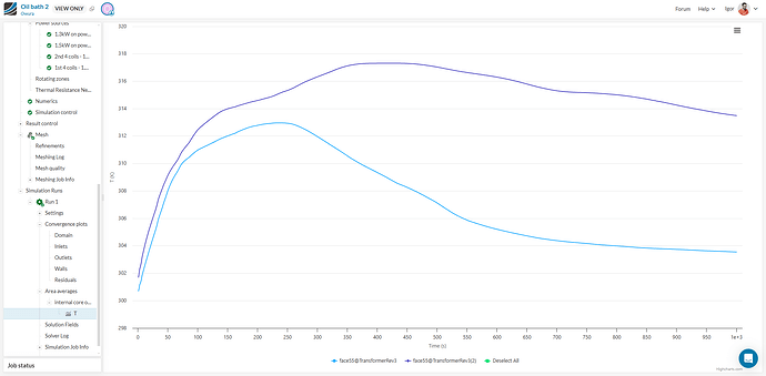

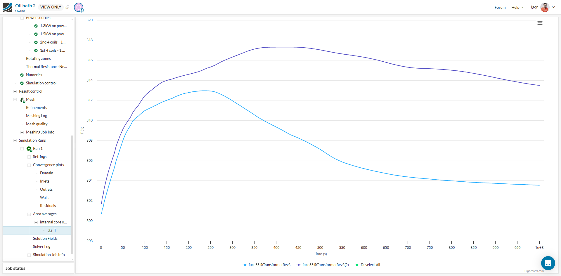

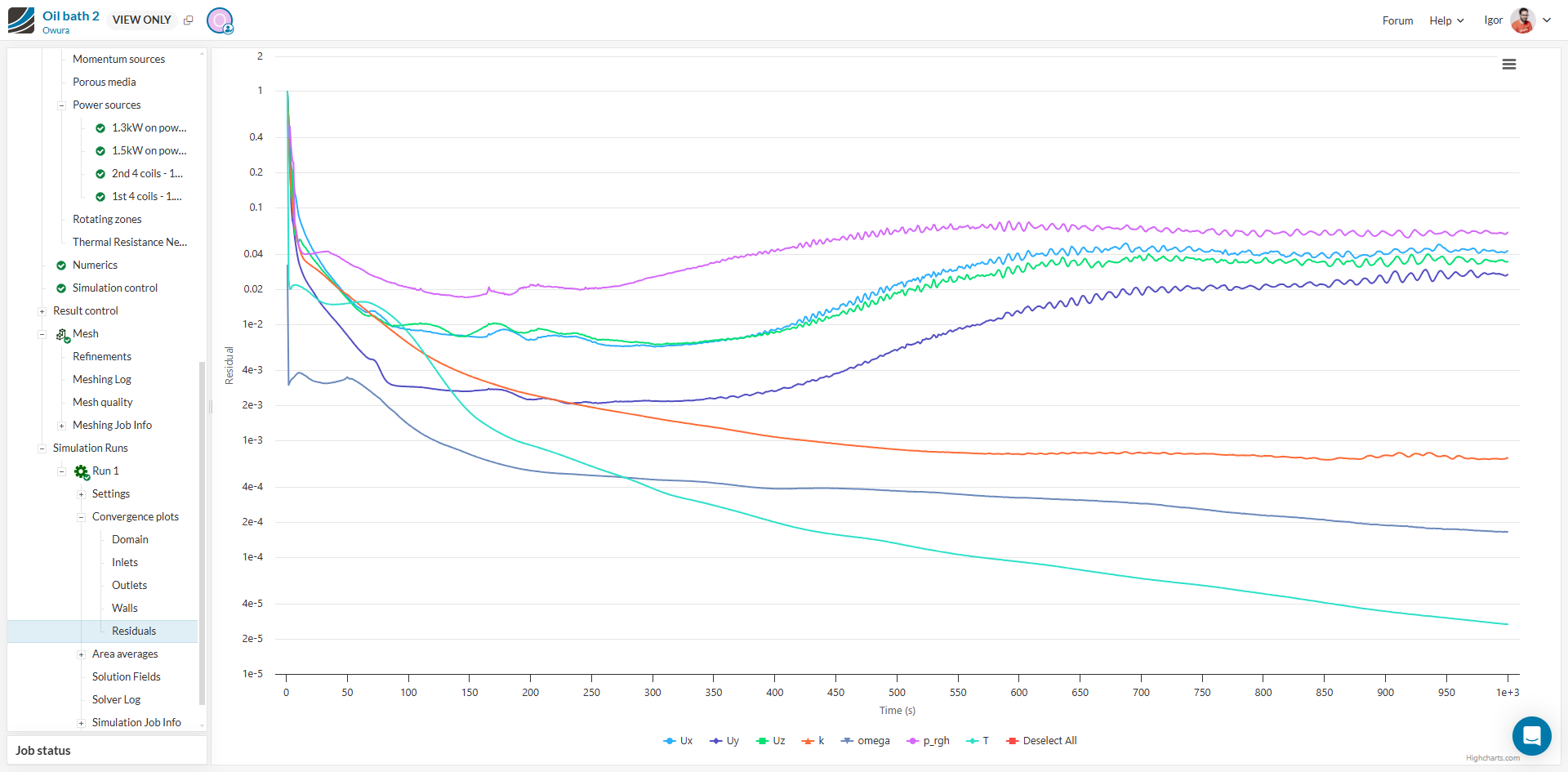

Looking at the convergence plots/area average, the issue seems to be the convergence of your simulation indeed:

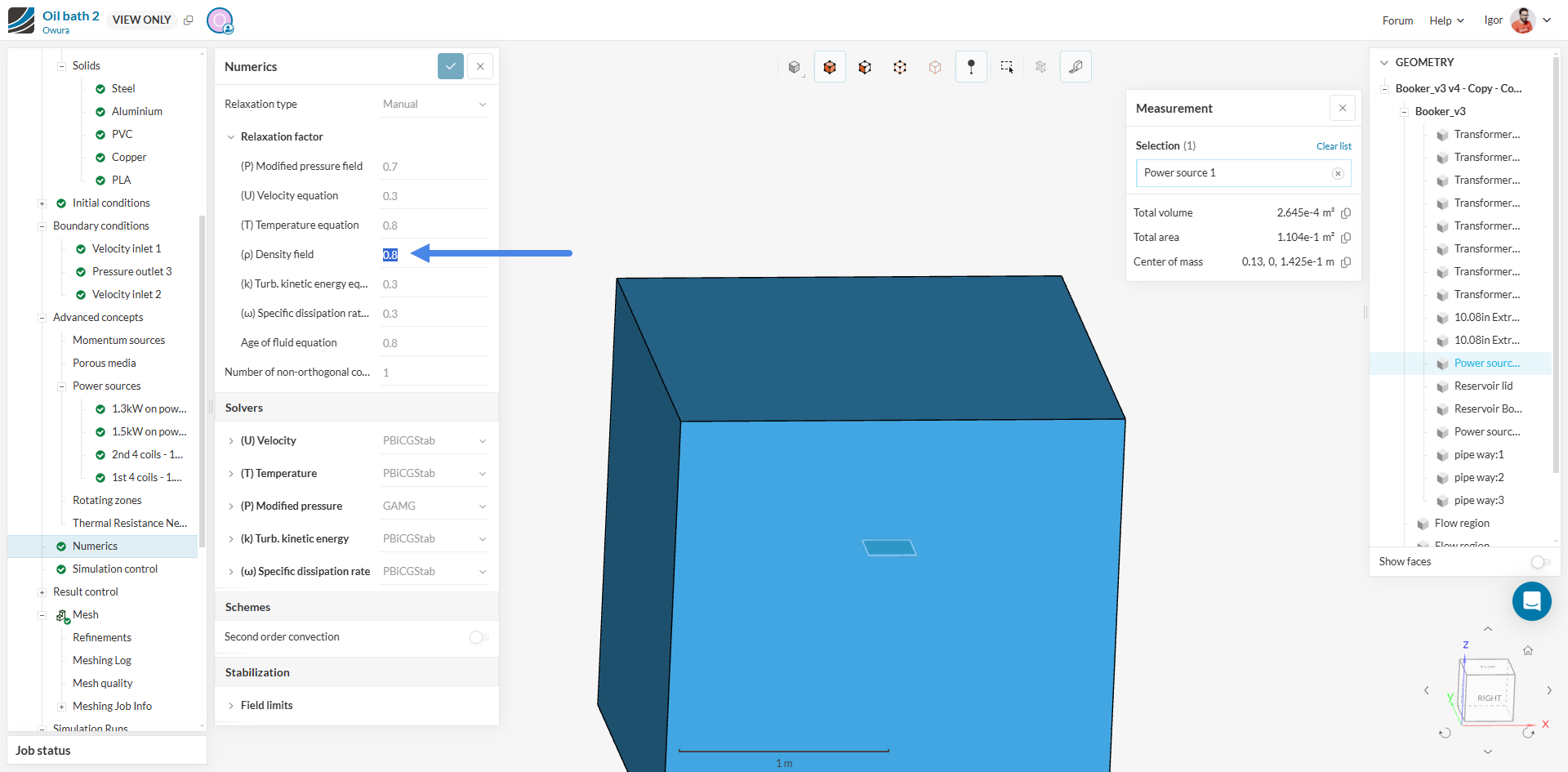

  1. Make sure the power source values are correct.
  2. Since your simulation is compressible and very sensitive to small variations in the density field, try setting it’s relaxation factor to 0.1:
